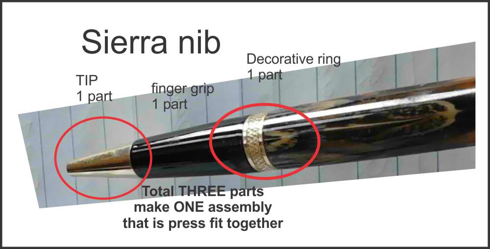

A Sierra kit i got from Exotic Blanks developed a problem after a few weeks of use, rendering it unusable. I used "ask question" on their website describing the problem with as much detail as possible.
Ed got back to me in less than an hour !
Told me how to fix the problem. Took a few seconds to fix a pen I thought was a goner. Their customer service is absolutely the best !!!!

Could you share the problem? Maybe others already knew this or it may help others in the future.
The Sierra twists from the bottom. The tapered bottom (just above the small tip at the very bottom) loosened, so twisting it didn't advance or retract the refill. It spun freely.
Solution Ed gave:
Unscrew the bottom component and use the press to press it again as the bottom section is pressure fitted and just came loose. PROBLEM SOLVED !
Solution Ed gave:

It is NOT a Gatsby kit, the kit in question was a sierra (from Berea). The "nib" is a three piece assembly, the middle piece is press fit into the tip and top "spacer". This assembly can come loose.
Introducing information on the Gatsby can only confuse the issue.
The Sierra from Berea is a one piece nib section and no pressing is involved. Are you saying that manufactured piece can come loose? I have made a lot of those and never seen that. This could be a problem because that is how you take refill out by holding that nib section and pulling the top apart off the tranny.

As they say, a picture is worth a thousand words.
Yes always a picture is worth a 1000 words. After you said this I thought that was what you talked about. I never had one come apart and I have made many of those type kits both Sierra and Elegant Sierras. Now at least I know and so do others that this possibility does exists. This was my point trying to get the info out there and recorded in a thread for future references. Thanks for the details.
