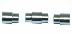

I have been eyeballing some of the yo yo ball bearing kits with interest that are available on some of the pen turning supplies sites.
I am curious as to how they are fastened onto the lathe for turning. Are they done on a mandrel , (pen mandrel or special mandrel ?) or a faceplate , or chuck or ... .. ..
I would be gratefull for a description of how they are actually turned .

Yes, you can turn them just like you do a pen, using a set of 10mm bushings on a standard mandrel, sold by PSI:
There are two tricks with making these yoyos so they spin true and don’t wobble: 1st, make the two halves exactly alike...its a good idea to get a scale that will measure down to at least 1/10 of an ounce, or one gram. And, choose a wood that has very consistent and fine grain, like maple and padauk. If you use a heavily grained wood, like Zebra or Bocote, the yoyo will probably wobble.
