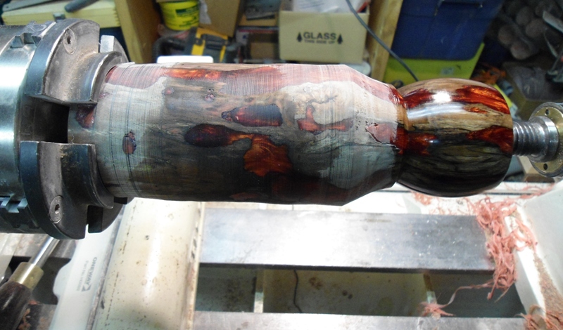

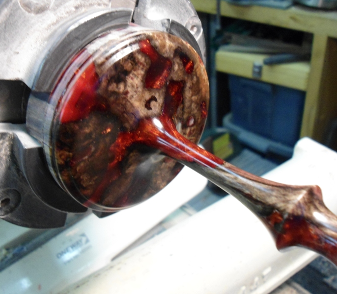

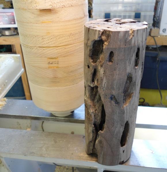

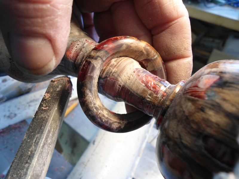

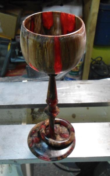

Well after all of the worthless wood or fusion burl pen blanks and bowl blanks I have cast, I took it to a new level this holiday season and made a goblet. The wood was punky and spalted maple. The blank was stabilized in Cactus Juice and then cast in Alumilite with red dye and gold pigment. The goblet is @ 7 1/4" tall and will end up getting more Minwax Poly and then buffed out on the Beall.

Thanks Cindy, but it's just a show piece....an art form. It's way to fragile to use anyway.
I'll get some better pics up in a few days that really show the red and gold effect.

Very Beautiful piece. By looking at the starting picture of just the wood you would never think it would turn out this well. I would love to learn this process. Great job.

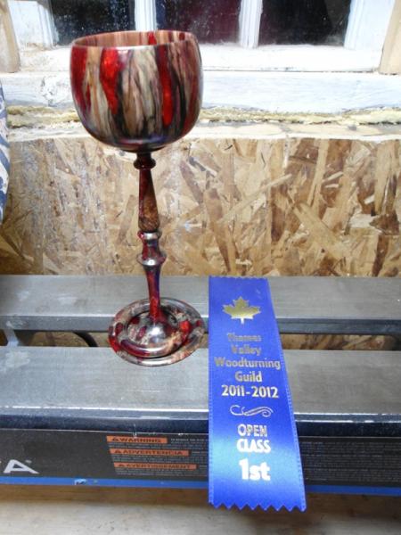

Thanks for the comments folks, it turns out that I forgot to mention that this piece was entered into the TVWG Presidents Challenge for a goblet turning competition. Here are the results.
