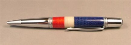

Dennis down in San Antonio has done it -- he shared a photo with me a while back.
Cast in Acrylic

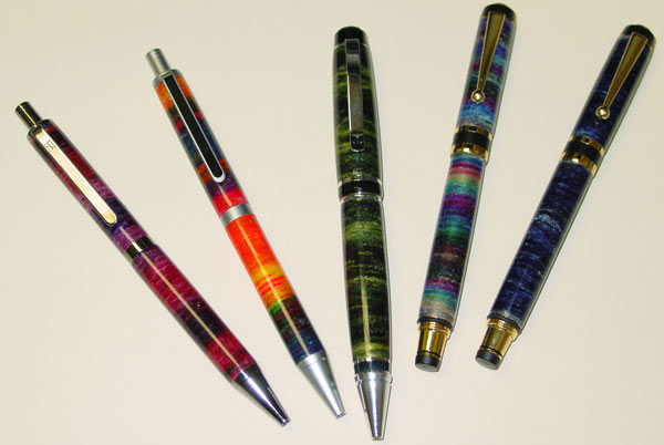

I've done it with string and cord and used a lot of CA. It might be a lot easier to cast it.
As Ed mentions test the CA before going ahead. I know for a fact CA reacts with polyester in a bad way and will start to melt the polyester.

I saw you thread and had to try a yarn pen,, I used 100% cotton dyed yard and thin c/a . I gues the hardest part for me was staring the wrap on the tube. The dark colors seemed to show a lot of 'fuzz' anyway made a couple gave 1 to a lady at work who knits and my daughter both were well received,
