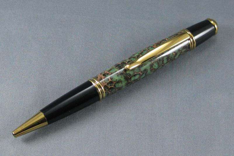

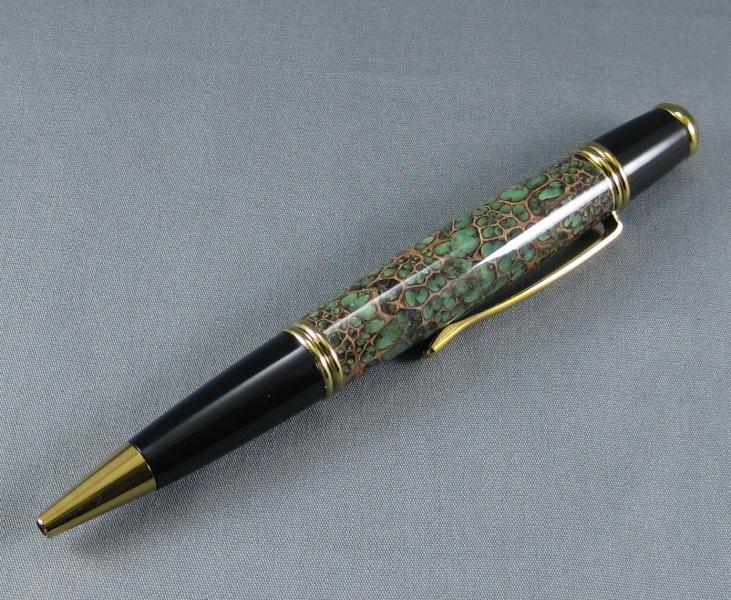

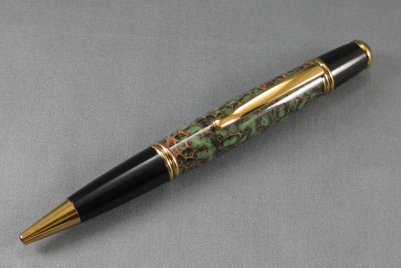

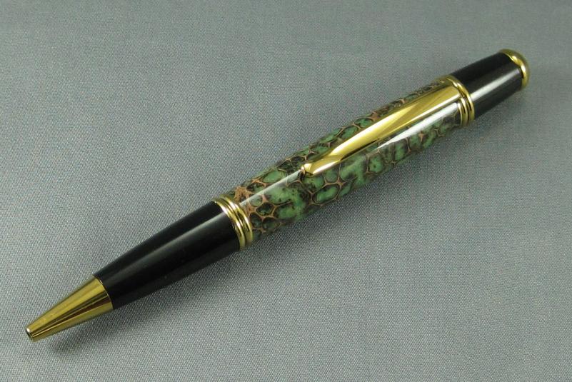

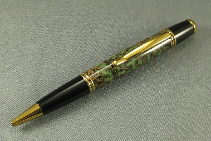

I am burning my lunch break trying to learn how to take pics. I built a box and need to fine tune my point and click skills. These photos are unedited just cropped. Which is the better pic. I don't have an eye for this because I have no idea what I am looking at.
For the differences I changed the ISO and used different White Balances (Auto, Daylight, Cloudy, Evaluate WB) in that order top to bottom.
I am using 3 5000K (switched from 6500K) bulbs at the recommendation of someone that takes some mighty fine pics.
The first are set to 100 and then I tried various White Balances (WB) for it.
For these I used AUTO ISO and the diff WB
I did take some pics at ISO 200 but the kidos had some prints on the lens that I didn't realize so I will have to retake those.

Number 3 seems to be the most natural in either group. I downloaded both of the number 3's and compared them side to side and there is very little difference. If anything , the second grouping is more grainy and not as sharp.

If the background is gray, I'd say the 4th in both sets are the most accurate, based solely on the color of the grey.
When you say you're not sure what you're looking at, I assume you mean with regard to the effects of the various WB settings? If so, with a gray background, you're looking for the one with the least color cast to the background. Some look too cool (green to blue tints) and others look too warm (yellow to red tints). The fourth in each set shows the background as pretty well neutral.

If your using a tripod the ISO change wont matter much. The 4th pictures should be the truest to color. You should be able to adjust your exposure for each ISO

One thing that bothers me is the bright reflection line that runs along the pen. I would think you need to move the lights around to remove the reflection. My 2 cents and BTW sweet sweet gum balls
