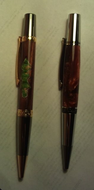

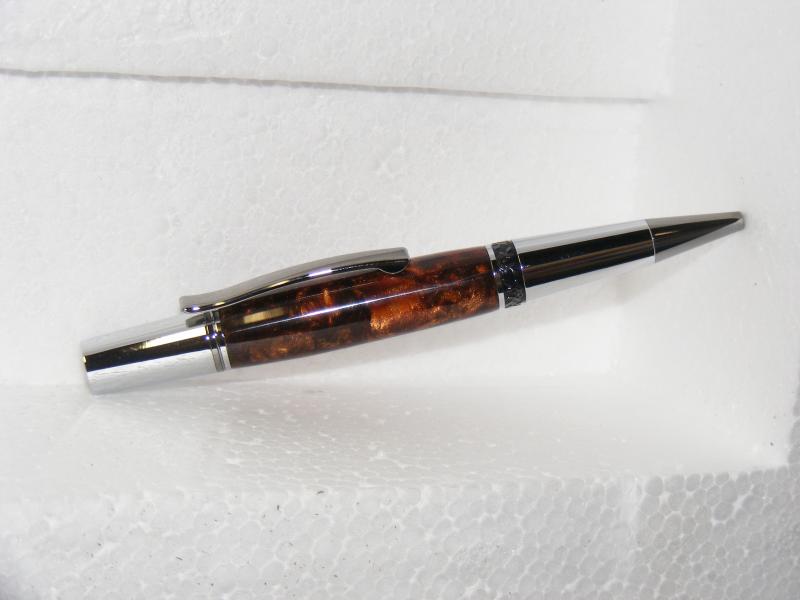

Here is the true EB for comparison. I personally think it's the better kit of the two.

Mike that is exactly the kit! Twists like a Sierra correct?
So which kit are you saying it is
The one that Mike is showing is NOT the same at the one you linked at Penefit.org. It is the Elegant Beauty and twists at the top.
Yep. Notice the difference in the clip ring between it and the one you linked to, right at the base of the finial.
The one I posted the finial is the twist, they are very sensitive to tube length like the cigar pens. But I've never had a customer have a single problem with them.

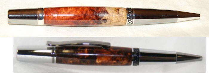

I took the liberty of borrowing Mike's photo to combine it with the Penefit.org photo to give you a side by side comparison. Hopefully Mike will be OK with that. They should be close to the same scale showing the lower one a little smaller.

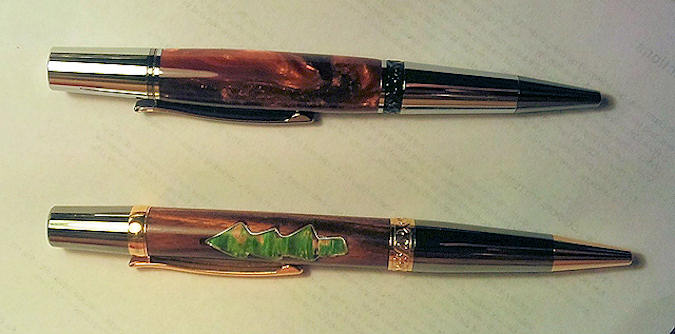

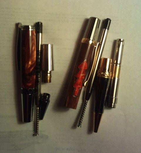

No problem with using the pic at all, in fact, A couple quick shots of the two side by side and disassembled. (had to use my camera phone as someone absconded with our Fujifilm :mad: as well as all the change in my truck)
