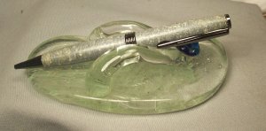

Vermont Soapstone in Black Titanium
See more from greenmtnguy
greenmtnguy
Local Chapter Leader
Nov 18, 2007
1,689
Chester, Vermont, USA.
This stuff is soft. Cut it with a hacksaw and turned it with a rasp and finished with sandpaper. No finish and it feels greasy like Talc. Not heavy like you would imagine but fast to work.

Very nice pen. I am a big fan of soapstone although it is a mess to cut and turn. I cut mine on the band saw and Table saw. I use regular turning tools to turn. I also micro mesh and polish, but no other finish. May I ask where you got the stone? Been getting mine from stone sculptures supplies out of Calif. I'd like to try some other resources also.
Very nice looking pen.

I got it locally. There are a few soapstone sources, but a lot of it is harder than the local stone. I asked a stone worker where to get some and he steered me well.

I think CA would work well. I sanded to 400. Probably a more detailed sanding to perhaps 1500 or 2000 sandpaper would work. Automotive stores have these higher grits. I will try more and do some research.

I use MM wet on my stone pens ----then a quick wax job to bring out the shine and they are done.
Had CA do some really mean things to stone.

Yes Gary, I curious what problems you have encountered using CA on stone. I use it all the time to glue pieces together, glue it to wood, etc. No problem so far. Heat should not hurt it they use it in wood stoves. Fact I read where heat makes it turn harder, which would be a good thing after you are finished turning it.
I put res. wax on mine and it protects it from finger prints, stains and keeps it shinny. You have ot wax it every once and a while. I think any wax would help it. Clear kiwi shoe polish is suppose to be the same as res wax at a fraction of the cost. My shaving set is holding up real well. I've been using it.
