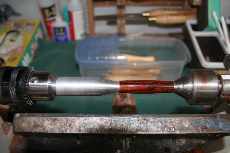

You are making things OVERLY complicated and this post is passing on mis-information!
You don't need to do ANY MODIFICATION to the mandrel bushings to start turning between centers. You don't even have to have a 60° dead center on those bushings!
THERE is NOTHING 60° about THIS dead center:
To keep things on the up and up - JohnnyCNC's bushings are drilled to 60° and do require that on the dead drive center and live center to be 60°. John's bushings are far superior to the stock mandrel bushings.
But when using stock mandrel bushings, 60° is not needed. Chamfering them as you mentioned is not needed either. It won't hurt (unless you accidently do them off center) but it only adds an extra step and time to using TBC.

In the simplest way of putting it, in order to turn between centers, you need two centers, one dead center in the headstock and one live center in the tailstock. Nothing miss-leading about that.
It just so happens that 99% of all the dead centers I have seen readily available on mt-2 shafts just so happen to be tapered to 60 degrees as do 99% of the center drills readily available! That is the ONLY reason I mention 60 degrees when talking about turning between centers! Nothing miss-leading about that.
In my opinion, the simplest way to mount a blank between two centers to quickly turn it to kit dimensions is to use the kit bushings that are sold by various vendors for $3 or $4 a set. You don't have to spend $28 on a set of custom bushings, that just overly complicates the issue! Nothing miss-leading about that.
The ONLY reason I drill my bushings with a center drill is to allow the bushings to run truer between the centers and to afford more contact surface area between bushing and centers. Nothing miss-leading about that.
The easiest and most accurate way I know of to drill a set of bushings is to use a center drill. A set of 5 center drills are readily available for $6, probably cheaper if you shop around. Nothing miss-leading about that.
Based on the above, I would recommend to anyone asking "What do I need?" that they get a dead and live center and a set of bushings and drill (or chamfer) the bushings with a center drill to match the centers. Nothing miss-leading about that.
