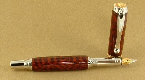

This pen is my first Snakewood.I need to thank Doc Stram for the blank,it was one of many he sent me during the birthday bash.I've hesitated to turn a snakewood because of its rep for cracking until reciving guidance from a few friends. I was told to treat it like a lady not a tramp and take my time with her.This will NOT crack...well maybe a small one,...or two.
If it cracks as Don Ward has said just fill the crack it still will be a beaut!Finish is lacquer.

Very nice Roy. I enjoyed one of my Snakewood's for almost a year before it finally cracked. Most of the others cracked within the first month or two. Enjoy it while you can:)

Nice pen Roy. Snakewood is a beautiful wood and makes a 1st class pen.
Yep! I've just fixed three snakewood statesmen for a gentleman in Los Angeles who was told by the maker of the three pens that they could not be fixed[:0] He was told there was nothing that could be done to fix a cracked snakewood pen. I have his name(the penturner) and I'm thinking of telling him differently. But, I don't think I will. This new customer will be a good one. He spent over $2K at the LA pen show a few weeks back and has purchased 2 very nice pens from me and one from Anthony.
So don't worry Roy. If it cracks just fix it. I've never had one crack a second time....yet:D

Roy, that is a beaut, I'd wondered if you dilled the snakewood and let it set for say a year, allow it get some temperature and humidity variations, then it probably would crack before the tubes were glued,I guess it would need to be turned between centers close to size before letting it move around, then fix the cracks when you did the final turning after gluing the tubes ?
