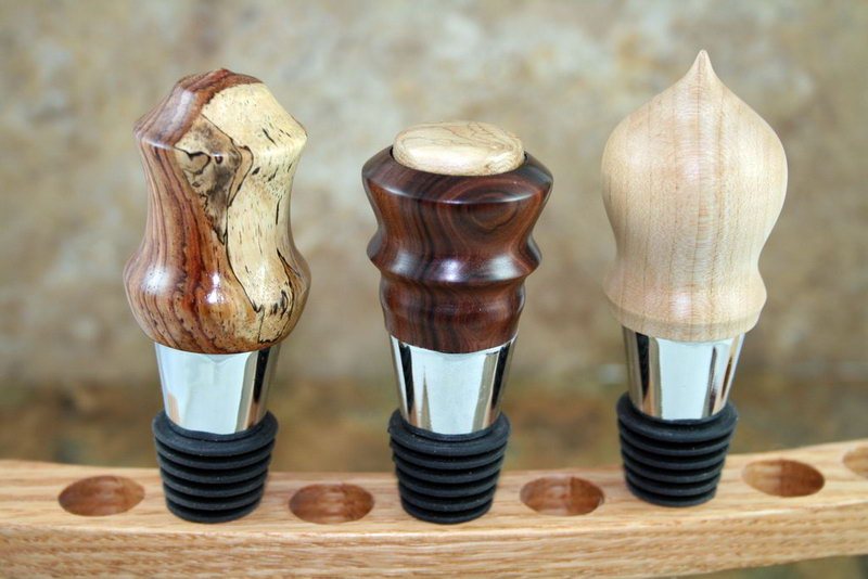

Thanks for the info, I was able to get it going without it self destructing... even made a few stoppers.
