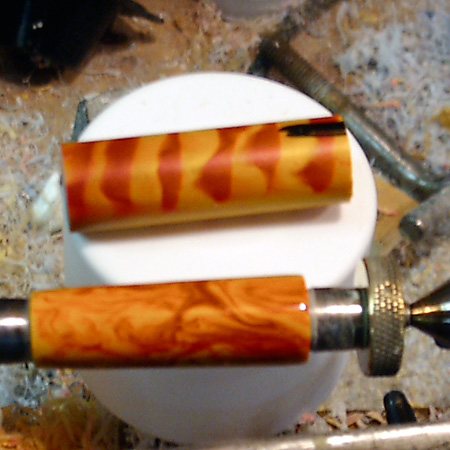

Took a bit of time to play around with an idea I had about swirling resins. This one is no more than a poured casting. No other method was used to create a swirl or blend other than the way it was poured. I want to try a few more things before I share how I did it. I was told this one looks like fire.
cozee
Oct 4, 2005
1,764
Sadorus, IL.
Automotive paint: PPG Concept DBC (red) and DCC (yellow) and the resin was from Mr Fiberglass.

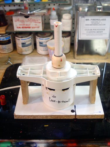

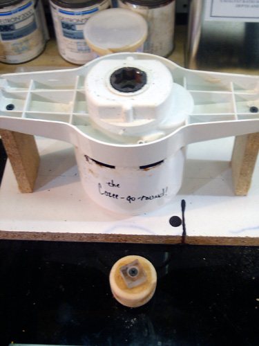

I figure that I would go ahead and post some pics of my helping hand when pouring to achieve the above swirling effect. Ice cream lovers may moan but I had an old electric ice cream freezer which the mixing can had chilled it's last 2 quarts. I figured I could use the motor for something sooner or later so I put it up with all the other potential future project items (Yes, part of me is a pack rat!!) I wasn't pleased with the swirling I was getting when the little idea bulb flickered and I came up with what you see here. Works great and if you move the mixing cups around you can achieve even more effects. I am presently working on a system where I can use more than 2 colors. As you can see, I use some hi-tech, Red Green approved shimming material for the mold to fit snugly in the holder yet allow easy removal. So, here is the "Cozee-go-round" in it's present state:
Since the drive in the motor was 8 point, essentially a double square, I cut a square of 1/2" clear acrylic to size and secured it to the bottom of the mold holder:
If the need calls for it, I can vary the rpms down to nearly 8-10. I also have a holder and mold for bottle stoppers but haven't poured any yet.
