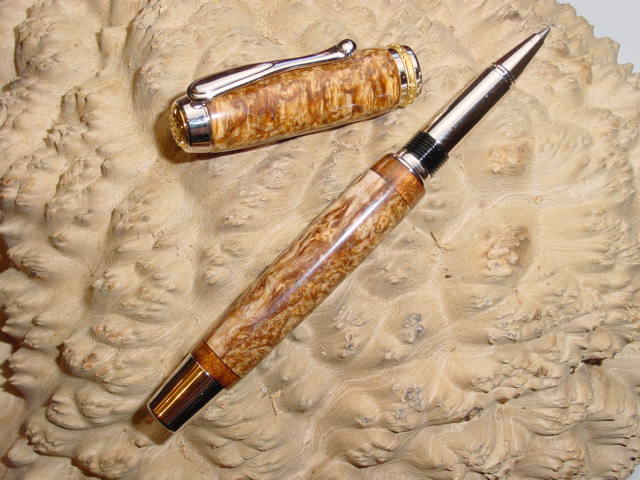

Just got the shipment of Stateman Jr pens in. Had this allready turned just waiting to match it with a kit worthy of it.
It is a slightly modified barrel 3/8ths longer than the regular Jr. barrel length. It is Masur Birch with snakewood tips on the end.

Hi Jim, No, the tubes are the same as a Jr. but I cut the pen barrel tube in half, cut the wood to the length I want, then glue the tubes on each end. This gives me a longer pen for a little better feel for a man, a touch longer is nicer when you don't post the cap. The only thing is, on a roller ball, you may have to add another spring or replace the one in there with a longer spring to keep the right amount of tension on the roller. Anthony
