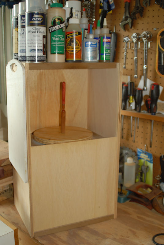

I finish my pens and most other small turnings with spray lacquer. I built this spray booth to try and control the over spray, make it easier to handle the items while spraying and give them a dust free environment to dry in.

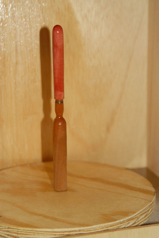

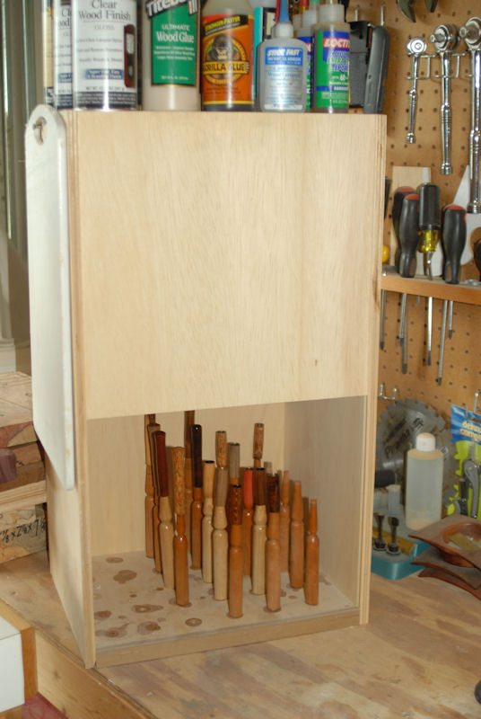

The upper portion has a circular piece of plywood, with a 1/4" hole drilled in it, mounted on a Lazy Susan. The floor of the lower portion has a bunch of 1/4" holes drilled in it.

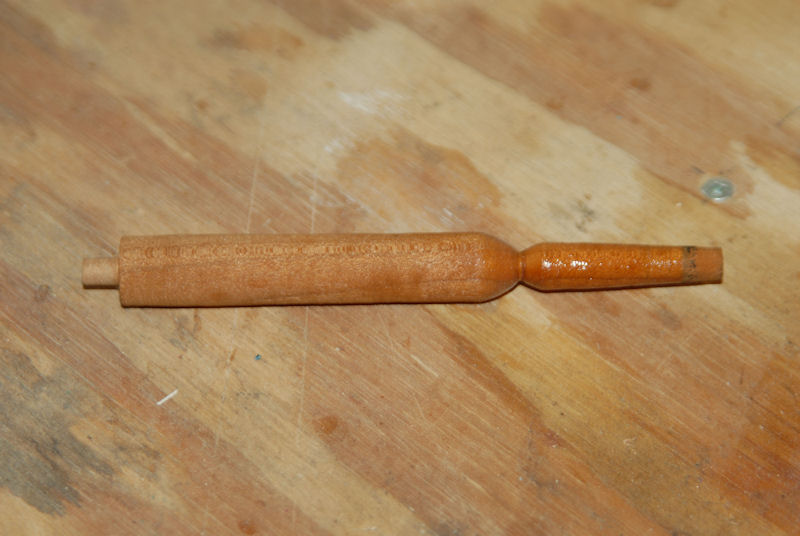

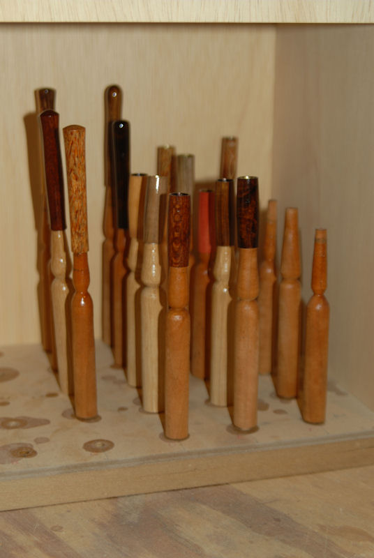

The "holders" were turned from pen blanks and have a tapered end, with a 1/4" tenon on the other end.
