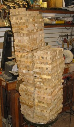

I took Friday afternoon off and spent alot of hours this weekend cutting these.
Over 700 blanks from the curly oak tree. I would say a little less than 1/2 have the great spalting too.:D

I will have to change the bandsaw blade after all this oak. I first take the slabs off the log with the chainsaw and usually take off the bark as well. I bring it home and cut the slabs into 6" long chunks and then cut them into 1" slabs on the bandsaw. I take those to the tablesaw and finish cut them all into 7/8 square. I've been making the final squaring cuts on the table saw so that I can see the figure and color better. The bandsaw is too course to see that. If I cut burls, I leave them 1" square off the bandsaw till they are dry. They twist around so bad drying that I need the extra thickness to make the blanks to size latter.
