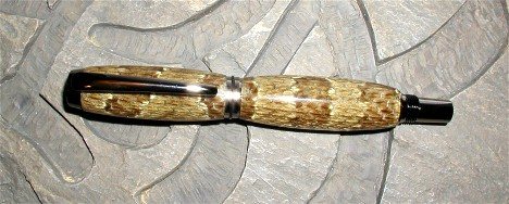

I got some rattlesnake blanks today from BB and could not wait to turn them. I think the lower barrel is too wide and will make adjustments on the next one. It is O.K. for a first try. This stuff doesn't turn like anything I've ever used before. Very delicate stuff. The kit is a black ti baron. Please critique if you would like.

The blanks are snake skin wrapped around the brass tube and then cast in polyester resin. You can go to www.arizonasilhouette.com and click on 'new products' to see the rough snakeskin blanks.

Everyone should MAKE one of their own at least once. OH, can't make just one, huh Anthony. They are fun to do.

Thanks for all of the nice comments. You are right about not being able to turn just one. I ordered two pairs from BB and can not wait to turn the next one!

I agree, they are fun, and everyone should make one... I suppose it doesn't have to be a snake skin one, just something wrapped around a barrel and cast in resin like that ought to do. I would advise against a newb turner trying it though, unless you can aquire the blanks cheaply. I found that my skew tended to give the best results for shaving those things down safely. My spindle gouge, even though freshly sharpened, was leaving little "pock holes" behind. (Both my gouge and skew were shap enough to shave the hair off my arm, I checked [:D] ). Got down close and then used some 220 sand paper to finish mine off. I wish I had access to snake skins, as I'm sure I could make these things myself, BB gets a nice premium for them... (or at least someone down the chain does. Here's to hoping I can sell them for an equally good price)
