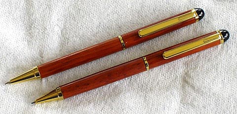

This one is available from Woodwrite,Ltd. They call it an Executive Slimline and it takes a Parker refill on 7mm tubes. A little larger than a standard size slimline but yet smaller than a Euro. Only available in titanium gold; your choice of black or gold Euro style caps. I've made a few of them and I like them. Makes a different yet nice looking pen.
A lttle difficult to order, they seem to like phone orders. I've had them return my calls on the weekend. If you miss him, leave a message and Terry will get back to you.
http://www.woodwriteltd.com/ExecSL.htm

Thanks Al,
They look great, that's what I was looking for. Will I have the flexibility to increase the CB diameter if I make my own?

George - I haven't tried to modify them. The transmission drops down from the top. If you ditch the centerband to increase the diameter, tube length may be an issue. Sorry I can't answer your question.

Al, have you made any of the executive slimline pencils? If so, what do you think of them? I've got a possible order for some pencils, and I'd like to find a good quality pencil mechanism.
