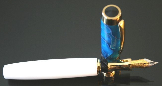

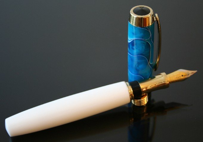

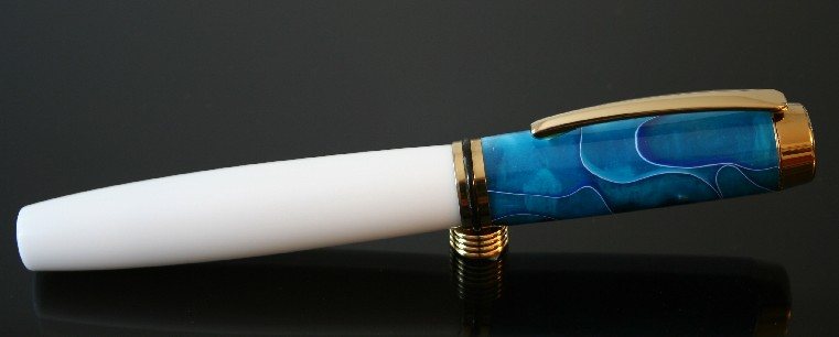

Gentleman with Caribbean Swirl and White Corian. The barrel shape fits the hand perfectly. It was going to California as a wedding gift... but may stay here...
Pictures could be better but I don't have the time to mess with it right now...
