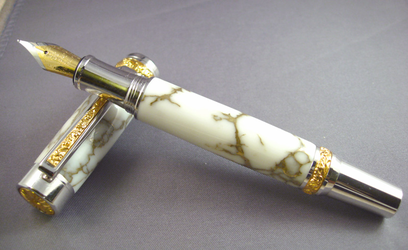

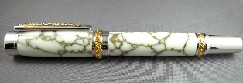

I finished this one the other day. Roman Harvest with White w/Gold Matrix trustone.
I had debated using Gold Titanium w/Rhodium accents but decided I liked it better with Rhodium w/Gold titanium accents. What do you think? Those choices are always difficult for me, but I tend to prefer the look of Rhodium with just a little Gold to set it off. :) Comments and critiques welcome.

Components fit the blank very well.
I am always impressed when I see a nicely finished truestone. I have tried a few true stones-dark to light colored-and they always break. Does not matter how sharp my tools are.

With gold in the blank like that, yes I think rhodium & gold plating suits it well. I know it's is a little overly blingy for some in here, but I think it looks:
AWESOME!!!

Nice job, Lenny! This is one of my favorites and a BIG seller! Beautiful execution.
BTW:
I don't recognize the nib. Is this David's stock nib? If so, It looks different than the ones I got.

Haynie, one of the photos actually had me questioning the fit at the end cap.:eek: I immediately went and checked (with two pairs of glasses on) and I'm happy to say it is fine! :):biggrin:

I agree on your color choice for the metal. Especially a lighter colored pen, the rhodium (or chrome or whatever) with gold accents is better. I go the other way only for dark, rich colored blanks.

Looks like you made the right choice on the platings Lenny. Right down to the two toned nib . It all ties together with class. Great job.
