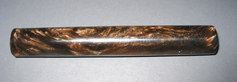

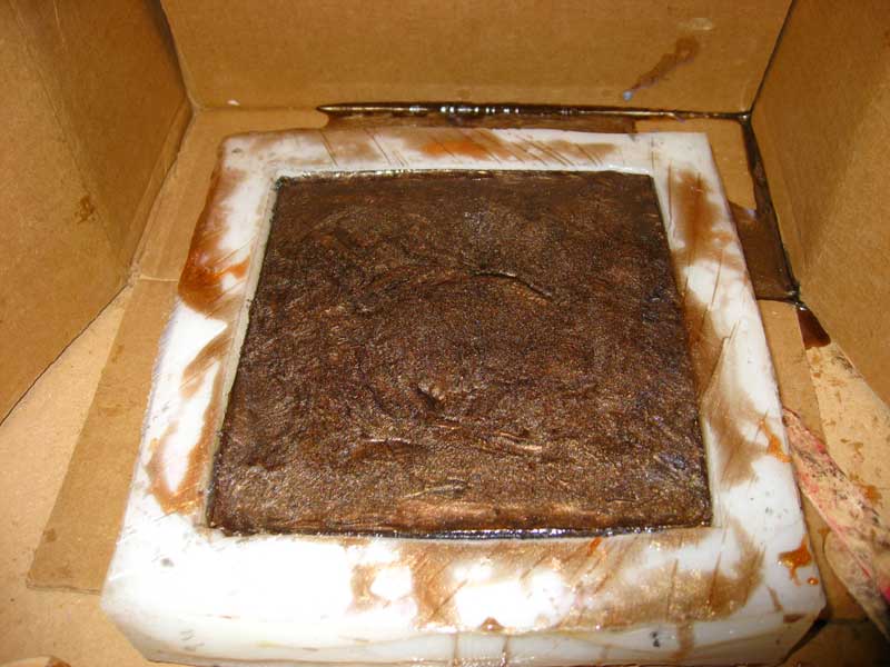

Once I discovered the temperature had reached the 50's today I decided to try and do another cast, my 6th.
A few weeks ago my wonderful wife, in an effort to help, had picked up some plastic cups. Now I had been made aware of the problems with using recycle code 6 plastic by PenMan1, but I threw these into my stash of casting supplies anyway figuring they would be handy for measuring amounts (with water) or whatever.:confused: BIG MISTAKE! :eek:
I forgot, and mixed up about 6 oz. of resin and (luckily) had it warming in a tub of warm water. When I picked it up to add to the mix ....:mad::frown::frown::redface::redface:
But in spite of that mental fopar I managed to get cast #6 poured. :)

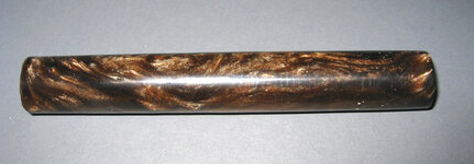

I got one cut away and turned round tonight just to see what was inside ... :tongue::)
I think I found wood! :eek:
