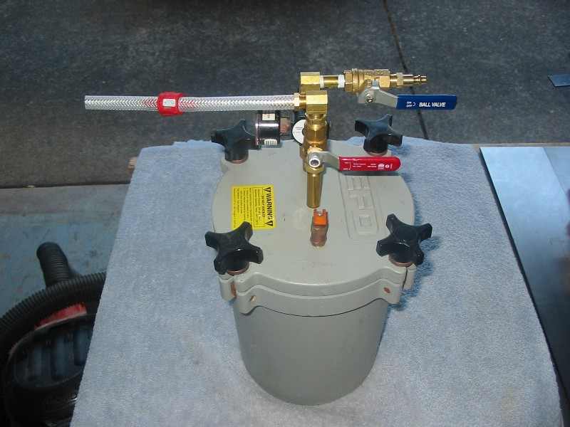

Well, I bit the bullet and bought a Pressure pot so I can do pressure/vacuum casting.
For the vacuum chamber, I welded up some .25 CRS plate into a four sectioned vacuum chamber that has a 1" thick acrylic top. Each chamber can contain separate loads of dye, stabilizer, resin, etc and be shut off if not loaded.
The Pressure tank came from EFD and is rated for 100 PSI (see picture.)
My question is: How to configure the connections on the pressure pot.
There is the orange pressure relief valve, no issue there.
I installed the vacuum line with a check valve that will run off my vacuum pump used for my veneer press. That way I can also run vacuum to the pressure pot as well as my vacuum chamber.
Then there is the pressure gauge that has a fitting on the top and a black plastic, threaded "something-or-other" screwed into the top. What is it? The plastic doohickey is closed off at the bottom, so there is no pass-thru...
Where do I connect the incoming line from my compressor? Should I connect a T fitting to the center fitting and add flow control (or two) that I can switch between outgoing (vacuum cycle) and incoming (pressure cycle)?
Should I remove the black plastic mystery piece or leave it be... Hummm... Any suggestions would be much appreciated!
Thanks!

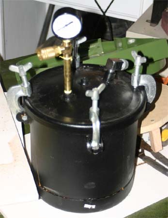

I use the paint tank for both vacuum and pressure. I have a gauge that will measure both. I use a quick connect on both the vacuum and pressure supply and have a valve in the vacuum line to shut off the vacuum when I stop the pump. I use the pressure regulator on the compressor to regulate the pressure and leave the compressor hose attached during the pressure part of the casting. I've included a picture of my paint tank lid.

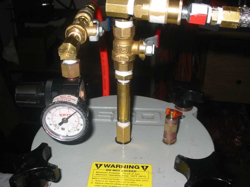

Here is the new picture showing the two ball valves (Blue is incoming from compressor)- (Red is outgoing from vacuum pump... with inline check valve) installed so I can close one or the other depending on the use of pressure or vacuum.
If, as mentioned previously, the PRV (Orange) becomes a source of vacuum loss, then another ball valve will go between the PRV and the tank.
Tomorrow is a disassembly, joint tape and reassembly test day! It's been nearly a year getting the time and materials to pull the trigger on this project! Thanks to lurking on the IAP site, this is the end result... nest stop, "Castaway"!!

Okay... two days of leak-down testing revealed only minor leaks in the obvious places. Re-taped a few joints, replaced tape in a couple of joints I assumed were OK and weren't and went to the Borg to get a couple of new fittings and #9 O-rings.
First and most obvious weakness was the 1/4" brass pipe in the center of the lid. It was locked down from under the lid with a fitting and an o-ring but still too much lateral play in the shaft created a leak. I thought I could get another 4" x 1/4" pipe with 1" of thread instead of the 1/2"... think again. This necessitated some Aisle Engineering. I took a 1/4 x 1" nipple and coupler and made an "extension" for the original brass pipe. O-rings, on both sides of the lid sealed the connection... no leaks.
The remaining leaks are isolated to the o-ring seal on the lid itself, which seem to be the most active, and a smaller leak in the regulator just under the pressure adjustment dial. The regulator is an easy replacement and not too costly. I am going to double check the lid o-ring for any compromised areas, as well as checking the mating surfaces for any flaws, etc.
I have had the pot under 70# pressure and, even with the remaining leaks, it took 20-30 minutes for the compressor to cycle back on. If I can resolve the lid leaks, it will most likely take a much longer time to cycle. If I can't improve the lid seal, I can still live with the current pressure performance.
Next up: A vacuum Leak Test... and this one will be a bigger challenge, I am afraid.
