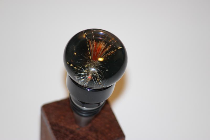

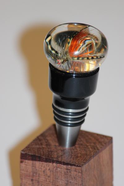

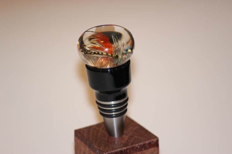

This was my first pour of PR that i have ever done.... Wow!! When it is said that this stuff might have an odor...that would be an understatement! hahaha.... But...I felt like i was in grade school and in Art Class...I had fun!
Seven Drops of MEPK and a ever so small dip of black colorant for the base and 20 minutes later another pour with another 7 drops of MEPK.... and placing the tied fly for the clear...about 8 minutes later..holy smoke...did it ever get HOT!
3 hours later... I tapped hole and mounted on the mandrel and i turned it down and polished it up with the Beall buffer system....
Next i'll work on getting the tiny tiny little bubbles out of the clear....but all in all it turned out very well i thought.
OH..and it's a Ruth Niles Stainless Bottle stopper... she has the best !
Troy

FireWhatFire.... It was amazingly easy :~) and dare i say fun... especially when i did the buffing...that is when the REAL magic happened... seeing the cloudy looking top portion turn crystal clear... and the fly just POPPED out magnified ...
I felt like a kid... taking it around and showing everyone I know.... "LOOK!! I did this!!" LOL
