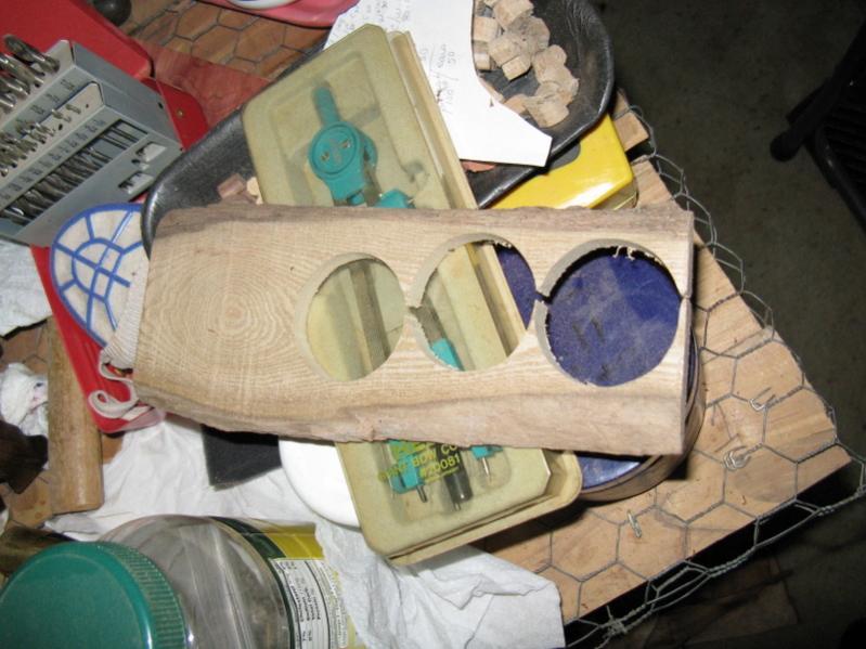

2nd --Mount the blanks on the center of your #1 jig----first thing you need to turn is the outside edge---gives you balance

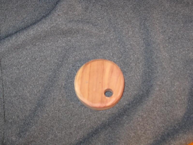

3rd----I just drill a 1/4 inch hole---just pick a spot and drill---no great math here--I do this step on my drill press----be sure you leave enough wood to support your cord.

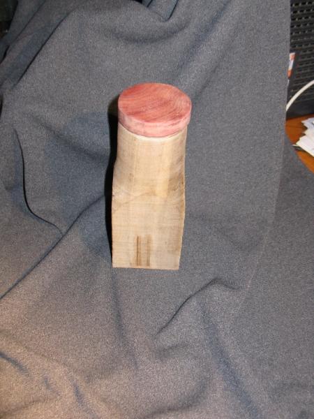

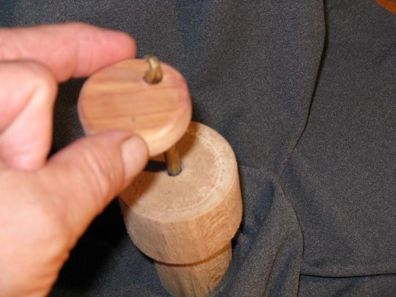

4th---this is the second jig---it's oversized so you can stick you pendant on off centered and still hold it securly. I use the 1/4 inch drill bit as a pilot shaft---it helps get everything thing inline. Now we turn the face giving the pendant it's final shape and sand.
