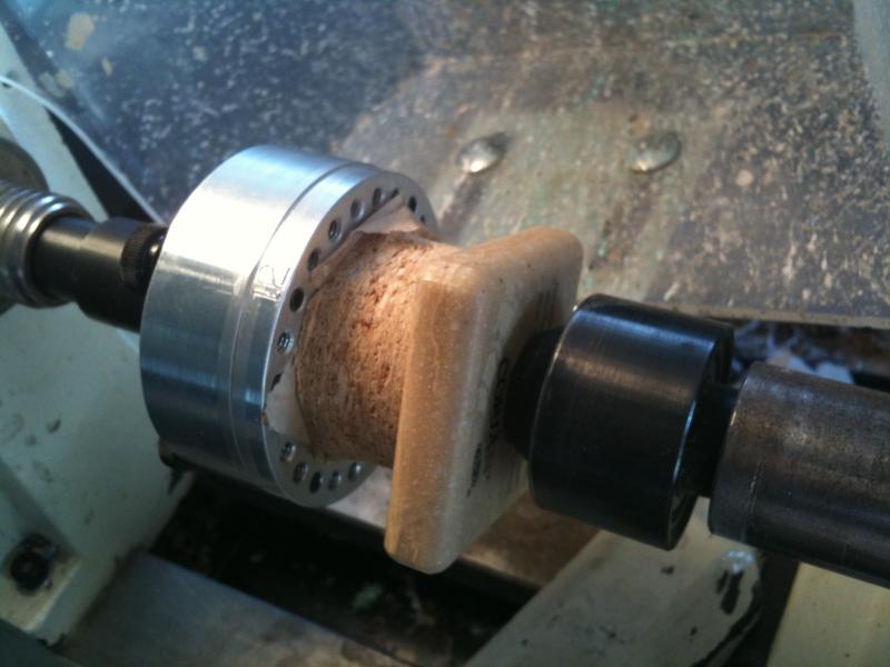

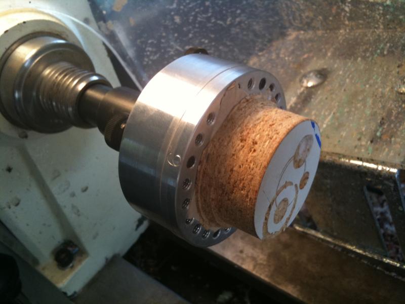

OK... Lots of pictures, some text.. Hopefully this will help.
My Setup... Mini lathe, Ruth Niles stopper Mandrel, Deluxe Backer plate.
See Thumbnails for closeups...
Picture 1 - backer plate on mandrel, sacrificial wood double stick taped to the plate.
Picture 2 - Material double stuck to the wood block. (in this case corian)... I suggest you have turned the wood block round and smaller than the pendant size desired.

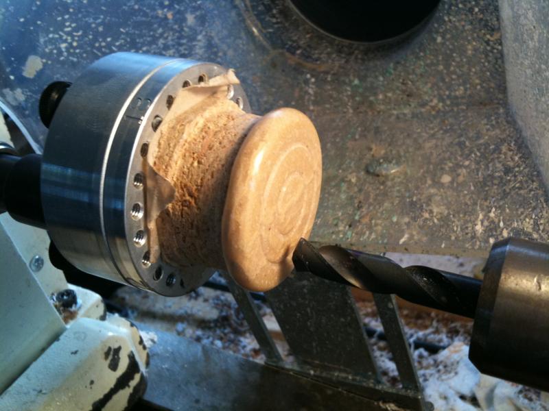

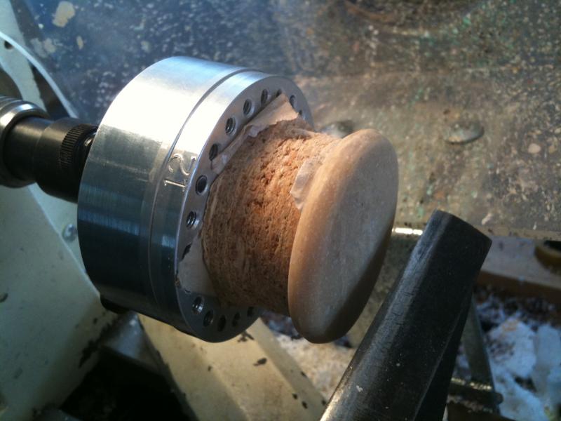

Picture 3 - Tail stock brought up to support material during rounding (optional, but makes it more stable for me) .... Lathe set fairly fast.

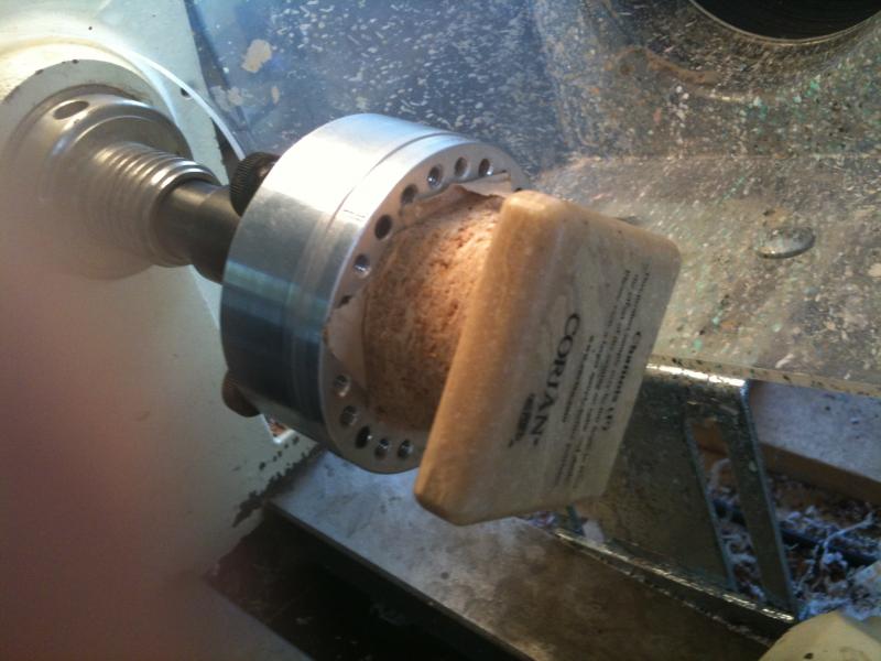

Picture 4 - Rounded off, thinned out to desired thickness.. Note rounded both front and back, which is why the smaller wood block rounded.

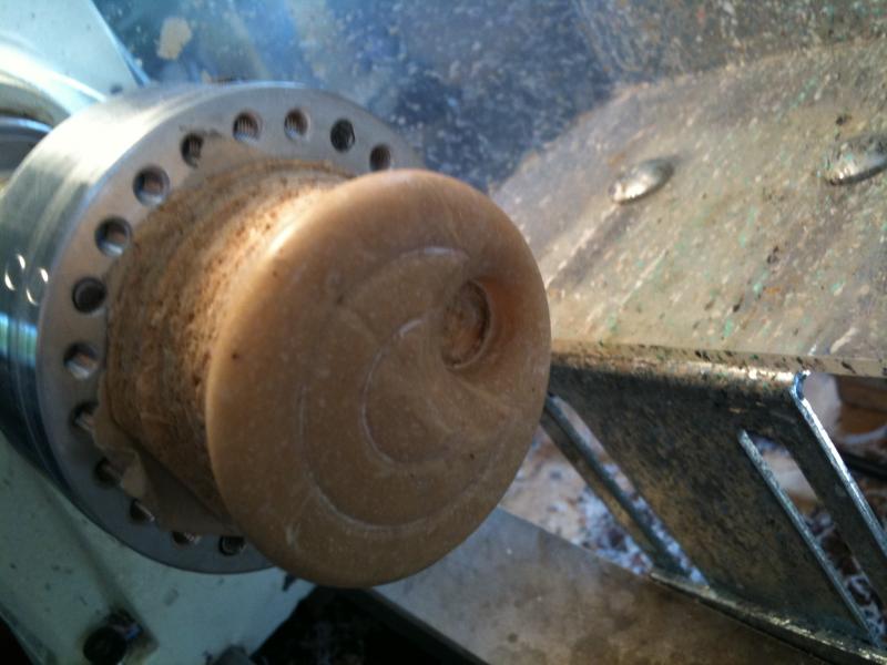

Picture 5 - After decorative cuts made, moved to offset whole and drill brought up to drill starter hole. ... Lathe set much slower for this and next steps.

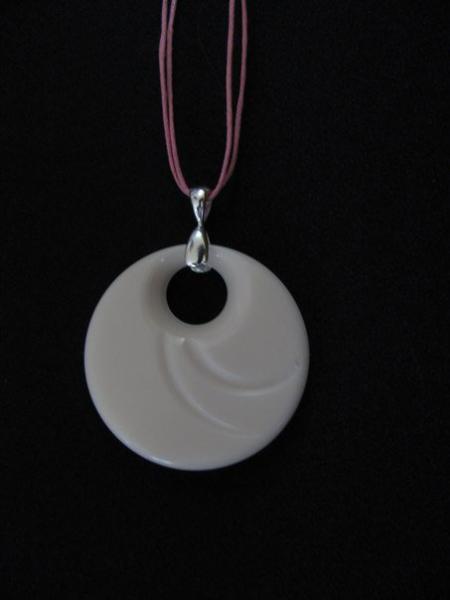

Picture 6 - whole rounded out and smoothed as desired.

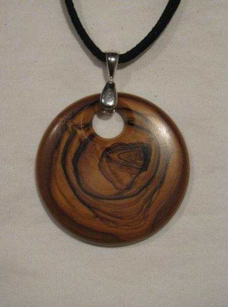

Picture 7 - Final product
Picture 8 - This is the next one I made and the reason for the 'deluxe' model over the basic. After all the above steps were done, rotate the front part of the plate to different positions and make other 'offset' cuts. The deluxe model is what will allow MUCH more variation in patterns.
This is a great little addon... The ways of mounting this are varied, but the tools works GREAT. I'm quickly getting the knack of this offset turning and looking forward to trying other things with it.
One last comment... As you are playing, I suggest WRITING down the settings you used. As you find variations you like, you'll want to remember how you did it!

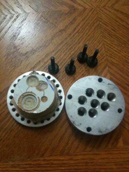

Hopefully these 2 pictures will help again (Richards post has some too, but I figured this will be easier than finding that thread in the future)...
Picture 1 shows the "mandrel side" with one screw removed.
Picture 2 shows the pieces apart (main part, 4 screws and face plate)
There is 7 offset holes in addition to the center one on the main piece.
The 24 holes are so you can easily rotate the part to different angles. For example, the 2 'arcs' in the 2nd pendant above are from the same offset hole, but rotated by a couple of holes.
And yes, the wood block is just double sided tape stuck to the 2nd plate. I've done multiple pendants with the same block so far.
The difference between the basic and the deluxe is the 4 additional holes, the screws and the extra plate with the 24 holes.

Yep.. There is a few holes that require using only 3 thumbscrews.
In picture 3 you can see I tend to bring up the tailstock just while rounding. This isn't always necessary, but helps with the harder materials.
Also - for waste block, I have been using a hole saw to cut pieces out of an old laminate shelf. The waste block doesn't budge at all and the face works great until I use too many of the different holes, then I replace it.

Are you drilling the through hole with the tailstock or using a drill? I still haven't had much chance to try mine, I guess I started off wrong by rounding my blank using the center hole didn't think ahead enough, Geez I've worked with indexing heads for years but this has me bum fuzzled.
foneman
Apr 16, 2008
93
Salina, Kansas
I do the same as you by rounding and shaping the blank using the center hole. Then I move to a different "drive hole" connected to the headstock to drill and use the tail stock with a drill chuck and bit. Be sure to slow it down a bunch to eliminate the vibration. I then shape the hole I drilled and sand. You can then move back to your center drive hole for any finish sanding or shaping or any other drive hole for other artistic effects.

o.k. I'm befuddled by the shaping of the hole after drilling. I get the part about moving it to an off center hole for the drilling but shaping the hole don't click...

Ok.. Answering some questions:
The bails (the clips) were found at michaels as was the leather cord. Still looking for improved versions of both, so if anyone gets some online please give feedback.
As for the hole, a skew works... But I often expand/taper the hole with a really small gouge that I have. (REALLY small - like 1/4" in diameter).

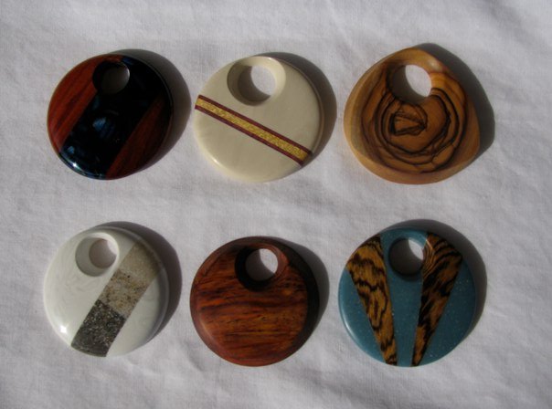

Dean, one more question, please. What size are these pendants?
Mine tend to end up around 1 1/2" to 1 3/4" in diameter (but I have made a few smaller) and I aim for about 1/4" thick when done at the thickest part..
Here is a few more for ideas for others:

Alphageek, The one in the top right corner - did you shape it that way because of the grain pattern? They match up just perfect, I think. With that said, the one to its left is my favorite. Gotta get some money for one of these plates.:redface:
alphageek
Former Moderator
Jul 19, 2007
5,120
Green Bay, WI, USA.
The top right was a slice of a BOW bottle stopper.. I have a round one with almost the same grain... Looks great both ways. The one next to it is corian with a strip of yellowheart & purple heart scraps. And the one next to that has blue chip acrylic and looks WAY better in person.
