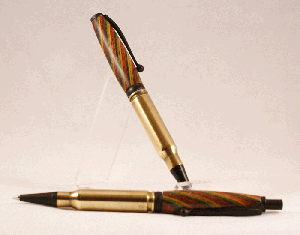

I don't know about the casing pencils, but, For the pencils I've done, the center is not needed. I drilled through the whole length and just made sure that the total length I ended up with was the same as it would have been with the CB. Here is and example. I call it the "dont loose me" pencil, given to my 14 yr old daughter.
Go to http://RedRiverPens.com/articles and read the article on matching pen and pencil. It is one of the slimline modification articles. Maybe you can modify or adapt it to your needs. PM me with any questions.
