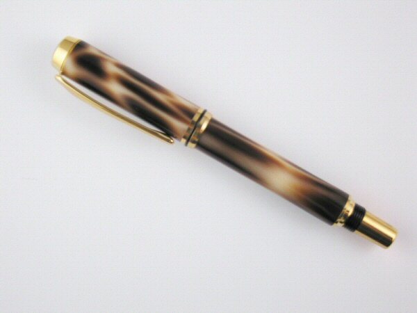

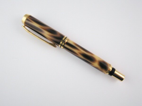

I completed these two pens recently from one blank. If you try this it takes some fancy cutting with a band saw and accurate blank drilling to do.

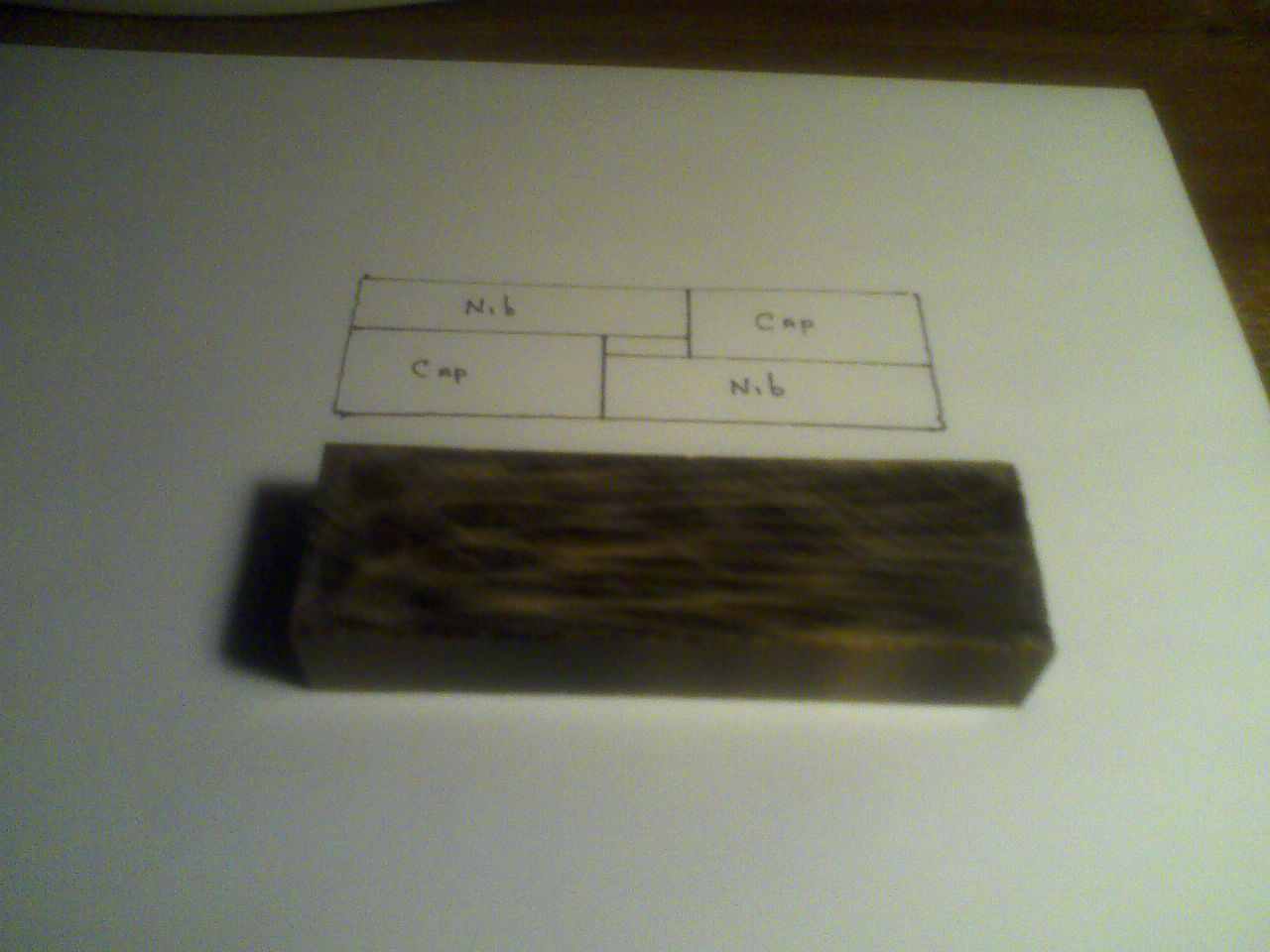

The blanks are *NOT* square. They are 3/4" thick, 1-3/8" wide, and 4-1/2" long. The cutting and drilling has to be exact!
I had to make cap pieces wider than the nib ends to have enough thickness on the cap pieces. I cut them with a band saw, not just a normal slice, looked like this.
C -|_______N_____|
________|_| |
N | C |
I got the blanks from Ed4Copies. I believe he posts here.

Anyway, the blank is *JUST* large enough to make two barons if you use a narrow kerf band saw, and cut the blank carefully. Cut 3/4" The cap tube on one pen will be next to the nib tube on the other pen.
Alas, my writing skills aren't any better than my art skills, so I took a quicky picture:
This is just with my cell camera and not lighted but should show how to cut the blanks.

I thought it had to be pretty accurate, too. Then Lou told me he "ran a bandsaw down the middle, then drilled the blanks on my lathe - go two barons!"
Continuing, Lou mentioned he would have been more careful if I had told him it was difficult.
Since then, I use the "Lou method" very successfully for barons. Jr. Gents version 2 can also be made with this procedure (BUT IT IS CLOSE!!).
