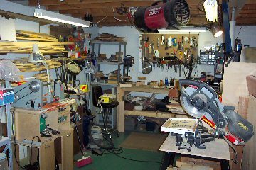

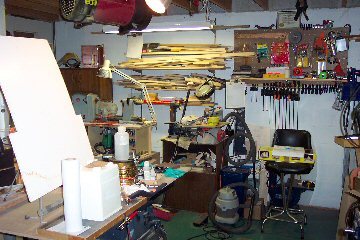

The whole shop area is about 12x15' . My lathe and my router table serve double duty , my lathe sits on top of the table when in use and underneath it when I'm using the router . The large table on the left in the 2nd pic is my table saw with a piece of 3/4" MDF as a portable table top and the easel is used when I'm airbrushing . The drill press sits on the back of my work bench and is pulled forward for use . This is an older pic so the bandsaw is now where the bar stool is . The overhead dust collector is linked to the lights so that when they're turned on , the collector goes on at the same time .

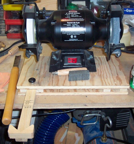

The 3rd pic is of my version of a hand made lathe tool grinding jig that was shown here a while back .

BTW, I really like your home made grinding jig, pretty slick!

Doug! I just got my first grinder, a two speed, WITH STAND! I'm making a table top for it this weekend..
How do you like your "shopmade" jig for sharpening? I can't think that it is any different than a wolverine, except for cost! [;)]
Any tips on making one? Looks pretty simple!
Michael ,
It works like a charm and you're right , not much different than a Wolverine jig except that this one didn't cost a dime , used odds and ends that were just lying around the shop . I only made 1 mistake - I marked the positions for the basic tools an the arm but forgot to take into effect that the tools are not the same length once they've been sharpened a couple of times but it still gives me a place to start .

... forgot to take into effect that the tools are not the same length once they've been sharpened a couple of times...
I didn't think of that, but saw a "tip" in a WW mag just the other day about making "angle templates" from strips of metal (wood could do the job too). They ground the templage to the same angle as each of the tools, and use that to set the table at the grinder for each of the tools... nifty!
