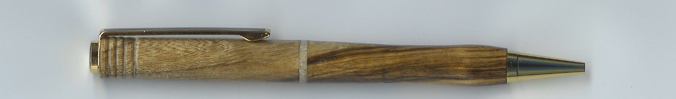

Andy Ryan
Apr 13, 2004
71
Mansfield, oh, USA.
Check this pen out. Found it the wood on a construction site. Turned out to be spalted maple. The kit is a PSI slim line.
<b>Image Insert:</b><br />
<br /> 42.29&nbsp;KB
