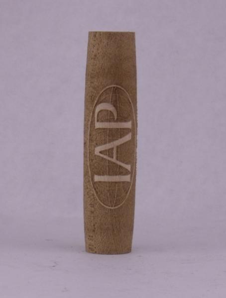

First one I tried was a gift blank Charlie included. It has the IAP logo and my name on it. The logo is complete with the small text and even the fine globe rings.

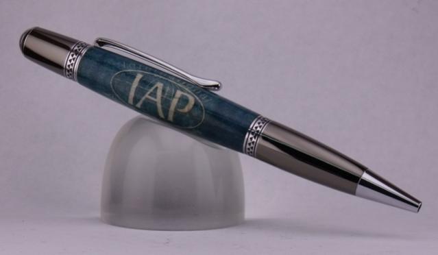

This is the blank that I used the wrong dye on. It was a really horrible grey with a slight blue tint. I washed this mostly off and re-applied the new stuff, so even now the colour isn't great.
I simply painted the entire blank in the blue dye and then CA'd it flush.
My theory was that I could simply sand down to reveal the high spots, then CA again.
I think I would have preferred this particular blank to have been engraved in the negative rather than with the raised image. I don't think blanks without the ultra fine detail ( text and globe lines) would be a concern though.
Sanding back down wasn't too difficult with a little care not to over sand.
I sanded down at one area at a time once I got close. I stopped sanding around the globe lines perhaps a little too soon to reveal them all, but I was worried that the adjacent blue area's were getting thin.
This blank wasn't all that challenging at all. Perhaps paint may have been a better option for this one though. But I did want to see the wood grain below the blue.

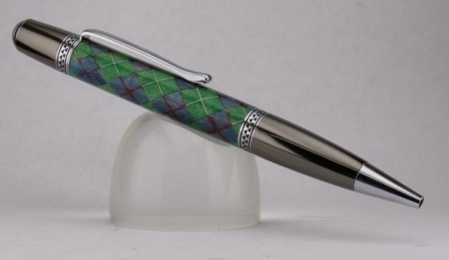

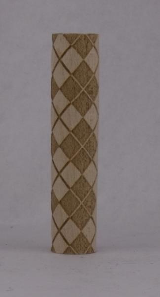

Now that I was feeling much more confident, I had a go with one called The Argyll. for those not familiar, Argyll is an area in Scotland and has a blue and green tartan. Other colours are seen but I don't think they should be called Argyll.

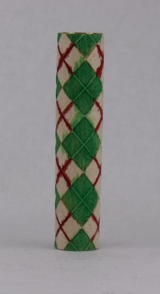

First I dyed the recessed area with green and the red stripes. No matter how careful I applied the dye, the wood sucked it along the grain like a sponge:eek: into the areas that I didn't want it, but I knew that it should sand out. I wonder if the wood was wet with water first, if this capillary action could be controlled more?
Then I CA'd it flush and then sanded down to reveal the raised sections and applied the blue. The sanding got rid of most of the red that bled, but there are a couple of 'thicker' lines.
Once the blue was on and CA'd, it was a simple case of sanding down again.
I don't think that using dyes will ever give razor sharp definition like segmented parts, but I think I'll stick with dye for the next few, now that I'm a bit more familiar with it.
These blanks are nothing to be scared of and make a very pleasant change from just slapping some CA on a nice bit of wood. I really enjoyed doing them and already have more adventurous plans for the others:biggrin:

You have far more patience then I, trying that argyle pattern like that!
(Half blind with coffee shakes and the attention span of a goldfish)
I'd have made a mess of that blank. How long did that take you?
skiprat
Passed Away Mar 22, 2022
In Memoriam
Oct 19, 2006
7,812
In a Skip in Wales
About an hour and a half tops.:biggrin: And the Argyll one has already dissapeared into my better half's bag. She's gonna need a suitcase soon!!!
I think she eats them for snacks.:rolleyes:
What do you or anyone else think about the idea of wetting the blank to try and prevent bleeding. I'll try it anyway tomorrow and see. I think I might just need to apply an extra coat to compensate for the dilution.:confused:
