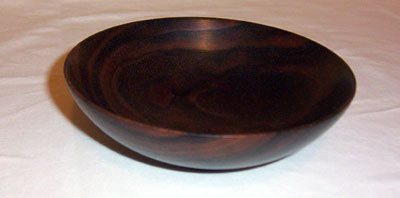

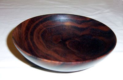

Some of you may have already seen this, but I can't help myself :D
This is some free walnut I got from a friend. It was actually quite a big chunk, but there were some cracks and worm holes in many areas. I cut out this piece and a good 30 or so pen blanks from it. While doing so, I ran into at least 3 or 4 pieces of buckshot, that was a first! :D
The finish is 2 coats of BLO and a thin coat of shelac just to give it a little sheen. :)
Thanks for looking :)

It's about 6" in diameter at the rim. Maybe 2 1/2" tall - could be closer to 3. The board I cut it from turned into pen blanks (that I still haven't done much with!). In it, I found lead shot in a few places! :p

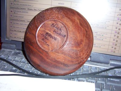

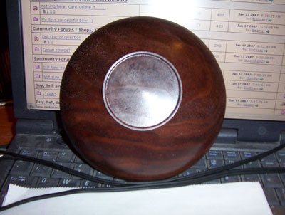

How did you do the bottom.. I have most trouble with getting the bottom like I want it... I don't have a big jaw for my scroll chuck... I usually cut a tenon to put in the scroll and then try to reverse chuck the bowl to fix the bottom. I have a jig I made of 2 pcs of plywood that I can bolt together that works okay for larger bowls, and need to something similar for smaller. - or get another scroll chuck that the big jaws will fit. I have an older one from PSI that supposedly will not take the wide jaws.
beamer
Active Member
Jun 22, 2006
341
Sacramento, CA, USA.
I actually made a set of "cole" jaws for my chuck. I'll take pictures of them and the bottom of this bowl tonight :)
Picture time! :D
Here are a couple shots of the bottom:
I really worried that the foot would be too small, but it actually worked out perfectly for the shape of it.
