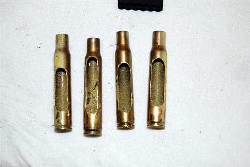

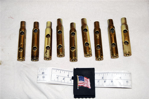

Here are some of my early attempts at cutting and filling a 30.06.
