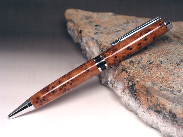

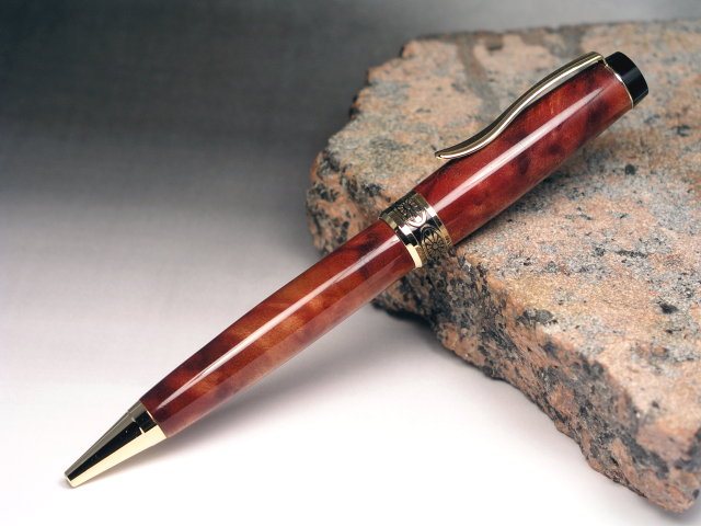

I have received quite a few emails regarding the method I use for my CA finish. Firts off I must say that I am flattered. The method I use is likely what many other people are already doing, but I thought I would post it here since I typed it out in a couple of emails already.
My method in nut shell is as follows:
-1800 RPM-
Sand with 240, 320, 400 Grit papers.
Wipe down with denatured alcohol (DNA)
Apply a thin sealer coat of Thin CA with 400 grit paper.
New sheet of 400 grit smooth out.
Wipe down with DNA.
MM through 12000 (DNA as needed between coats to remove sanding debris. Usually between each three of the MM.)
Two coats of Myland's cellulose sanding sealer.
MM last four grits through 12000 again.
DNA
-Slow lathe to 500 Rpm. ( or Slowest setting).-
Apply two coats thin CA with Costco Paper Shop towel.
Air dry only betweencoats (NO ACCELERATOR).
Apply Two Coats of Thick CA, as smoothly as possible.
Air dry betweencoats. (If you do need to use a light application of
ACC, I wait at least 1 minute after each CA application, and only
use the Aerosol from a distance. I don't have any issues with cloudiness
or bubbles this way. The pump ACC does not work for me)
-Speed lathe back up to 1800 RPM.-
Sand with 320 Grit(Sometimes 240 grit if I went crazy) to remove any ridges, swirls etc.
Sand with 400 grit.
DNA
MM through 12000.
DNA
Buffing wheel with White Diamond only.
Hut Plastic Polish applied with paper shop towel.
TSW.
It seems like a ton of work, but really takes about 20 minutes from start to finish. Each grit of paper and MM is a very quick, light sand letting the papers do the work. There is not a ton of time on each grit, though I do make sure I have removed the sanding lines etc. I have worked on this method for quite a while, and it really works the best as far as results for me.
Some people will say that there are overlapping grits or stepping back at times, but it works for me. Maybe more of a ritual like a baseball player that goes through his nervous supersticious dance prior to each pitch!:D
Cheers,
Fangar

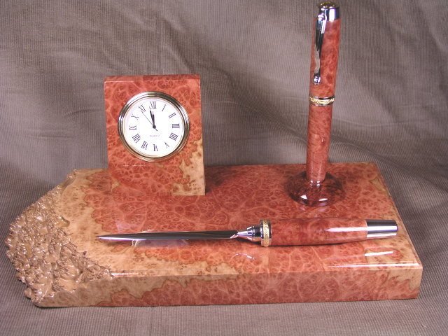

Has anyone tried this method of finishing on larger items? I'm curious how it would work on something like a small box or mallet? Would there be drying issues? I just love the shine and have yet to try it(still waiting for supplies) bu i have a few larger items i wouldn't mind protecting a bit better.
Fangar
Apr 27, 2005
1,837
Wilton, CA, USA.
Originally posted by Lioncourt
<br />Has anyone tried this method of finishing on larger items? I'm curious how it would work on something like a small box or mallet? Would there be drying issues? I just love the shine and have yet to try it(still waiting for supplies) bu i have a few larger items i wouldn't mind protecting a bit better.
Usually, for larger items, I use spray lacquer for that gloss. It can be done. I have used this method on several bottle stoppers with good results. However, I find that the main reason I like it is the durability factor as a pen is usually handled a bit more than a box. A mallet would not be the best option if it was to be used as the CA when dry is a plastic. Any impact like that of a mallet would likely cause cracks. It would be fine for a display gavel that wasn't really going to be used. I use lacquer for my flat work too.
The pens are CA, the base and clock stand are Deft Spray lacquer.
Fangar
