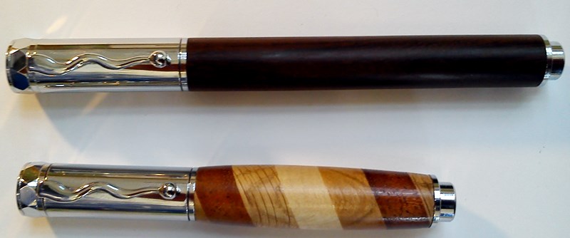

I had the same request from a customer last week, and this is what I came up with.
It's a mag cap cheapo Zen copy, but length wise the tube is the same as a Zen. I replaced the tube with a Sierra tube and epoxied the parts in. I could have cut the tube down, but I've got loads of Sierra tubes.
The insert is a Monteverde mini rollerball which I got 18 of from fleabay for £10!
