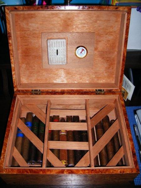

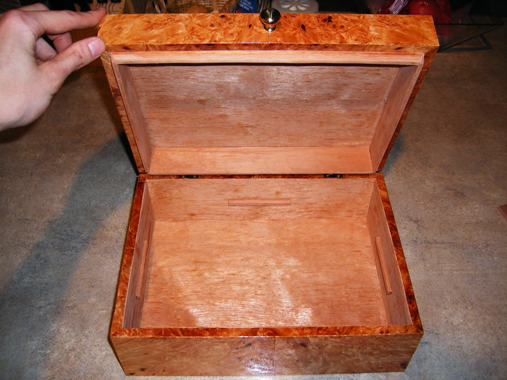

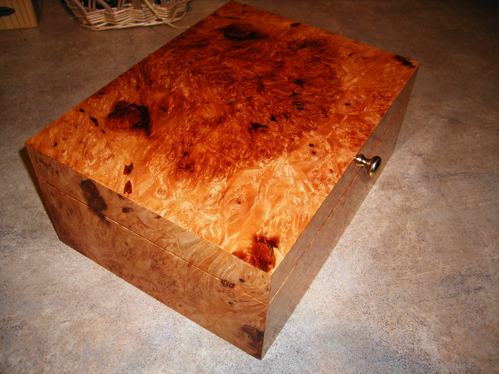

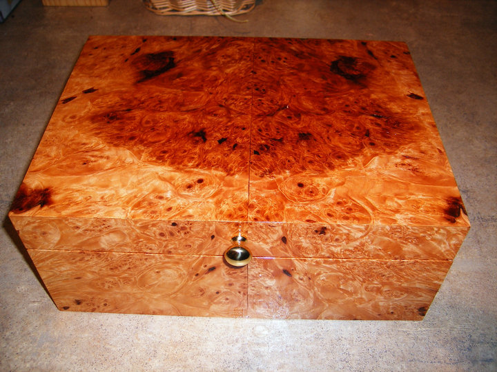

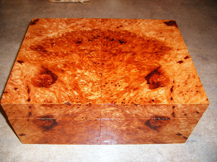

This is the third humidor that I have made. The box is made out of birch ply and covered in maple burl veneer. It is lined with Spanish cedar. The finish is 15 coats of wipe on glossy poly sanded between the coats.
As far as a humidor it is excellent. The seal is perfect. I have since added a humidifier and hygrometer into the lid. It holds the desired 70% humidity. It will hold between 50-60 cigars based on the size.
I was offered $400 at a local cigar store for the humidor but I am going to keep this one. Thanks for looking and letting me know what you think.

Asbolutely stunning. The bookmatching is perfect.
Did you vacuum press the veneer or make your own clamping mechanism?
I made my own clamp. I made sure the veneer was where I wanted it then I clamped it down. I cut a piece of plywood to distribute the weight and used about 60 pounds of free weights.
Due to the nature of burl, it was very wavy and bumpy when I bought it. Before I could do anything with it I had to soften and flaten it. They make a veneer softener with a watered down glue and volatile liquid that you soak the veneer in then press it. I was then able to cut it to size when it was good and flat.

Here is the finished humidor with the humidification, hygrometer and shelf.....plus a few good sticks. It still holds a perfect 70% humidity. I want to build another!
