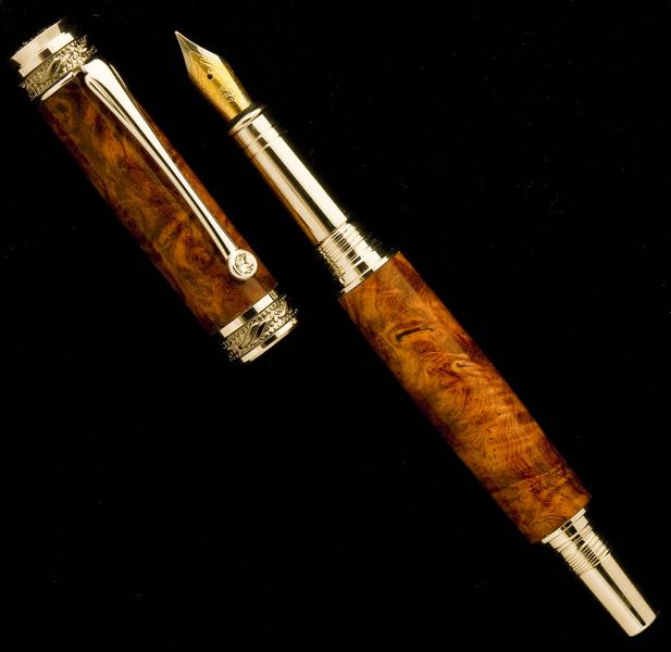

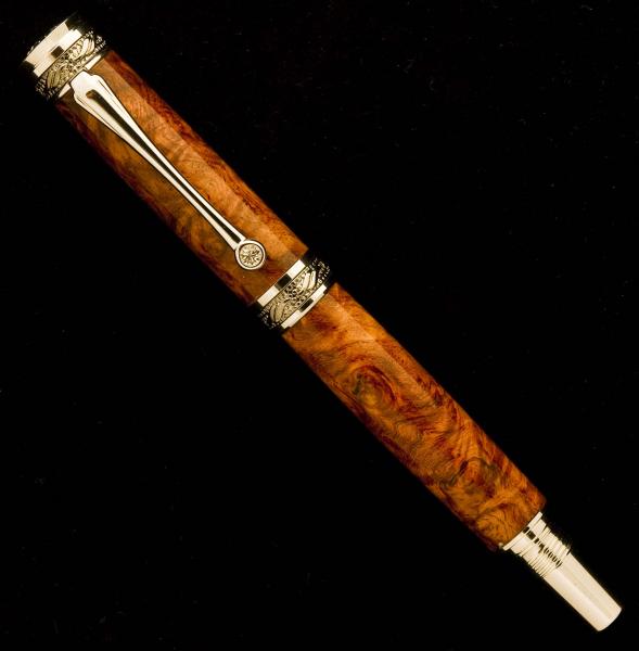

Made it this morning. A Rhodium and Black T/N plated Majestic Junior Fountain Pen with Amboyna Burl Wood. Enjoyed turning it. Sanded to 600 grit. Cleaned with rubbing alcohol. CA medium X 8 coats. MM to 12000 followed by HUT plastic polish and a coat of Ren Wax. Comments welcome and, as always, thanks so much for looking. Hope everyone has a great day! Doc:)

Doc, Blank and componets really go together great but is it the photo or is the final underturned?
Roy, I looked at the picture and thought the same. However, when I look at the pen, it looks fine. The amboyna on the cap end seems to be a darker wood and the photo seem underexposed in that area. Nevertheless, looking at the picture, in retrospect, I do wish I would have left more bulk on the cap end of the pen. Roy, thank you for taking the time for the constructive comment! Doc
