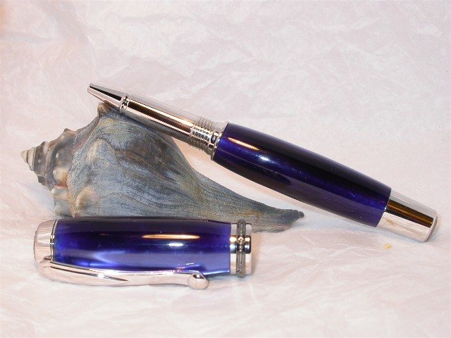

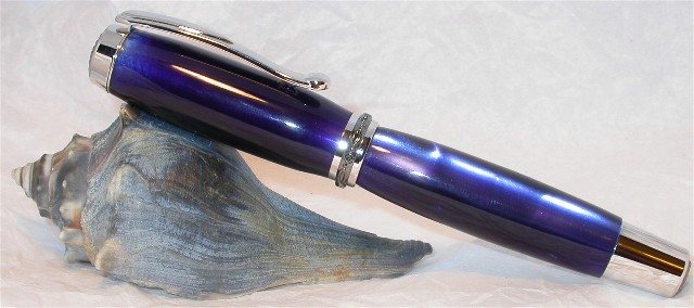

Blue Lucite on a Jr Stateman II kit. The pictures don't do the material justice - there's a depth tho the shine that is just amazing. Well worth trying at least once!
Open and closed, for your viewing pleasure. As always, comments and critiques are welcome...will be posting it over in the Critiques forum too.

Good looking pen. I have some of that material comming today. Any difference in working with that material.
Again Good job.

The lucite is pretty hard, and likes to chip. I knocked the edges off using some sandpaper stuck to the faceplate for my lathe, but if you have a belt or disc sander, that will work too. This pen was turned mostly using a scraper; next time, I'll rough it down to close to the appropriate size, then switch to a skew just because the scraper tended to encourage chipping, whereas when I use a skew, I can control the aggressiveness of the cut much better. However, this may be due to my lack of experience with the scraper.
Best of luck with your pen - I can't wait to see it! Yours too, Coach!
