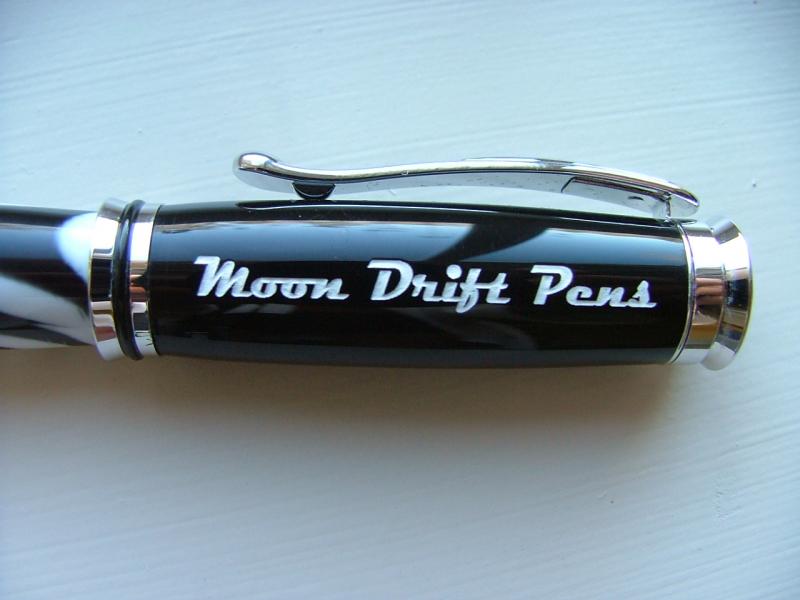

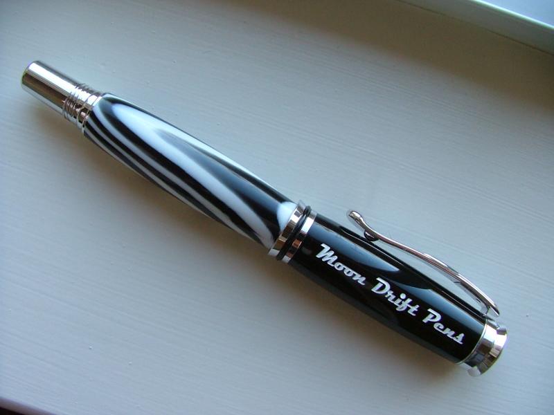

All, I just want to pass on my thanks for a great job by one of our IAP members. Stan (mrcook4570 of mestraridesigns.com/turners) did a great job of laser engraving my business name on 3 of my finished pens as examples for my customers. I would highly recommend Stan for any laser work you may have. Thanks again Stan.

---- that is a nice job (both on your part and Stan's)
---- Stan also raises Labs, and there is a rumor that these well trained dogs are the actual operators of the laser engraving equipment.
Joe
