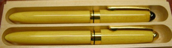

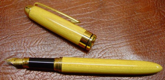

This set of a Euro RB and a Euro FP in Osage Orange was finished with Enduro WB poly lacquer from Compliant Systems. I am a lousey photographer and I do this without a special set up. To make matters worse catching the brilliance of the lacquer finish on the OO is difficult to capture because of the lightness of the wood. That said I think you can see that the WB rivals CA and if you were to ask me I would say that it also feels "warmer" to the touch.
