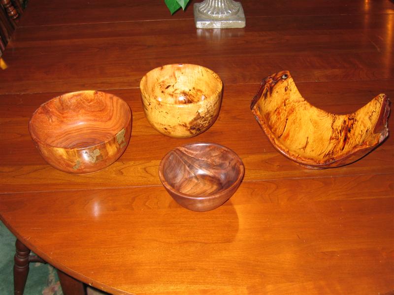

So what did you do on Labor day? I spent most the day in the shop.
Group picture of what was done.

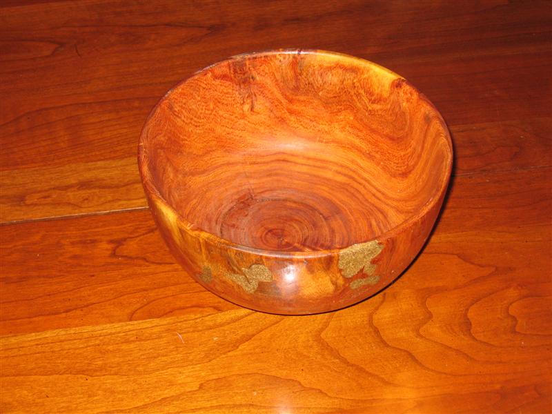

Mesquite bowl with brass inlay. I have never turned a more abrasive wood. It burned through the edge on my tools.

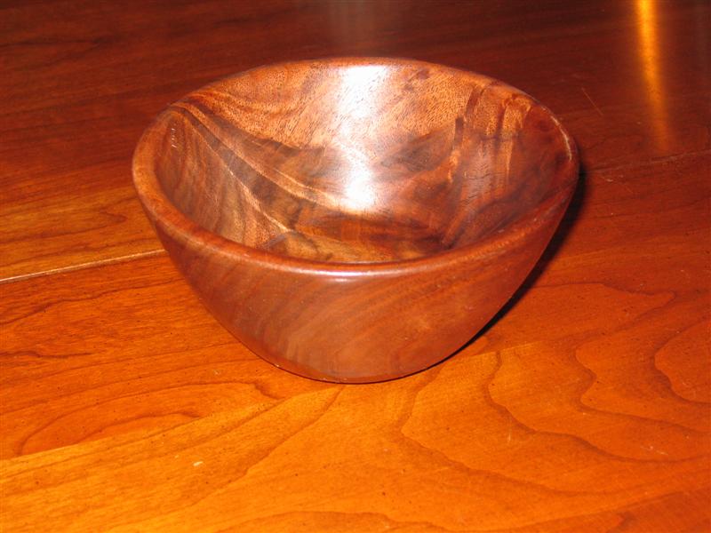

The kelton tool saved this bowl from the center of my larger black walnut bowl.

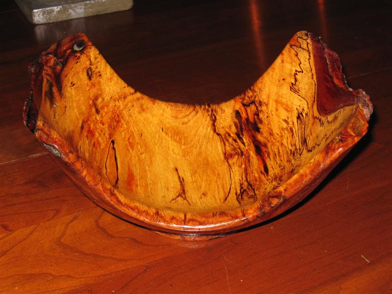

This is the first half of a piece of spalted pecan I won at the club raffle.
This is the other half. I did not want a small bowl and the wood had such great color, I decided to carve the sides down to get this.

Awesome stuff! You have three of my favorite woods there. I really like the winged bowl.
I'll have to agree with you on the mesquite, it is tough stuff. Don't tell anybody but I wear a glove when turning it. [8D] Not only for the heat but the dust dyes my hands, and it is a bear to get off.

The pith is in the bottom of the mesquite bowl. It wanted to drop out, but nothing a little CA could not fix.
Over time, it could develop a crack but most of the time the finish will prevent rapid moisture loss so mainly it is just a movement issue.

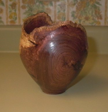

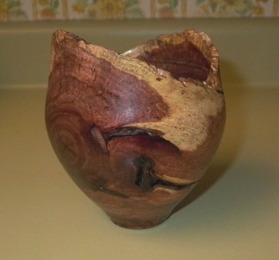

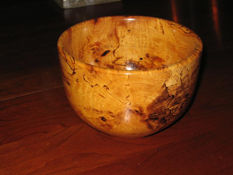

Are you talking about something like this? This mesquite bowl is part of my first bowls...maybe my 5th and the inside is very rough but the idea is there.

turned that way, you will find that the bowl will tend to bulge out at the pith. I have had a real problem with dogwood having its eyes bulge then crack. It will crack, just a question of how much ca and when.
The best thing is to rough turn then glue / butterfly the cracks after it drys then do your final turning.

FYI, this mesquite bowl is still almost round [:D]...a bit oblong but you cannot really tell by feeling or looking. Mesquite has almost equal shrinkage lateral and longitudinal wise.
