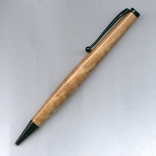

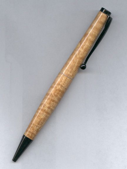

I've had some BLO for a couple of weeks and decided to see what it would do for some maple that needed a bit of help. Finished both pens with CA. I like it.

Beautiful finish.... and now I got to see what a slimline without a centerband looks like!

They look great! The no band slim looks sleak. Just curious, how long did you wait after applying the BLO before applying the CA? The finish looks awesome.

I sparingly applied the BLO with a paper towel after which I immediately buffed it with a dry paper towel. A few minutes later began the CA application.
