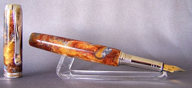

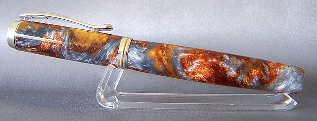

A Jr Gent platinum fountain pen done in Woodturningz Molten Metal blank. That blank done with Jr Gent and Churchill kits are my best selling pens. It seems like everyone picks that color up first. I'll be ordering more of these blanks tonight.
This is also the first time I went with a different shape on the closed end barrel. I normally put a little curve towards the end but I decided to try a more blunt end. Thanks to Jim in Oakville for the inspiration to try out a different shape.
Any and all comments or critiques are welcomed.
Lance
