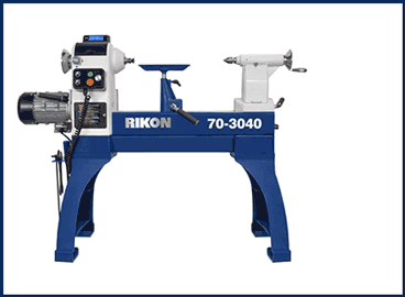

Both look damn good buys to me. Remember you'll need a chuck as well ,to make life easier. Then again I found birthday and present suggestions helpful to family
