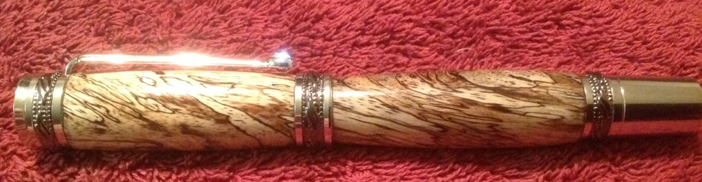

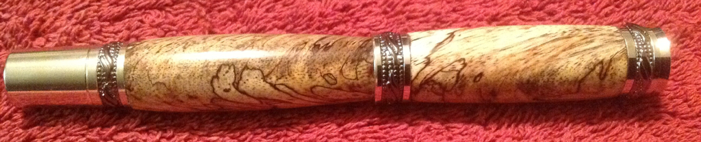

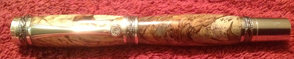

Well, after MANY trials and tribulations, I have finished this pen.
Turns out my blanks that were sized for the navigator were a little shorter than the ones for the majestic. This came in to play big time when I was assembling the pen, as the final wouldn't fit on due to the plastic tube on the center band being too long for the shortened blank.
It took a lot of fiddling and work, and this is the result. Let me know what you think of my "save" project.
