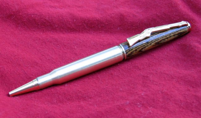

30-06 case with Bocote upper barrel. Bocote is finished with Hut Crystal Coat and TSW. Still haven't figured out what to put on the brass. Maybe Renaissance Wax?

John, whatever it means, it is a compliment. Unlike me, Anthony doesn't have a mean bone in his body[:)] Awesome pen, and the Bocote is a perfect wood to accent the cartridge. Now, I am going to shamelessly copy your work and not tell my unsuspecting customers where I got the idea! [:0]

Okay, sorry for the bad pun [:D] I can't be the only Star Wars junkie around here [:D] Stars Wars.....The Dark Side.....Dark cap, unlike all the other antlers and bullets we have been seeing, your was different and nice looking. [;)] It was a compliment John [:p]

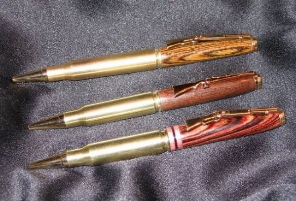

At any rate, thanks for all the kind words. Since I built that one this morning, I've done two more, both using .308 cases. They look a bit stubby to me.
From top to bottom:
Original 30-06 & Bocote, .308 & Peruvian Walnut, .308 and Cocobolo with Purpleheart CB, all on Slimline kits.

Great pens!!! Now a question. How did you drill out the primer pocket? I tried drilling a 357 casing just to see what it takes and found that I could not hold the casing from spinning, just keep sticking the bit?!

Kevin, I punched out the spent primer, clamped the case in a pen vise on the drill press, and drilled slowly - abround 800 RPM. Got some way cool curly brass ribbons.

Nice additions to the first one John, I think the bocote really blends in well with this style pen. Not that I'm knocking anyone's work, but I still think some of these would look better if there was no clip put on. "these" meaning others that have made them and not yours imparticular.
Bullets just don't have clips.
