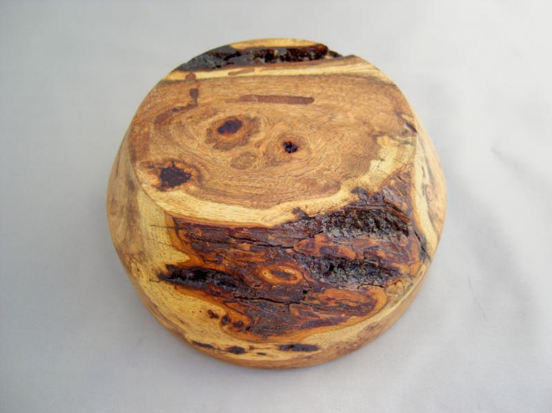

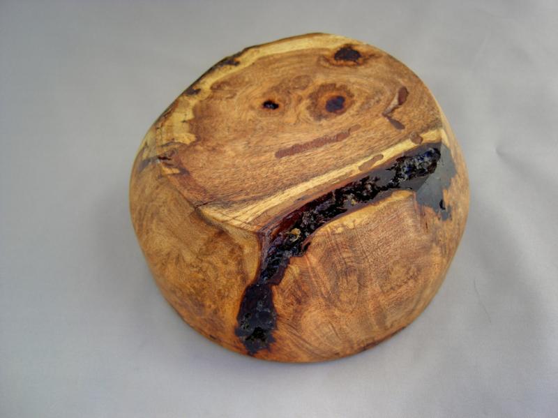

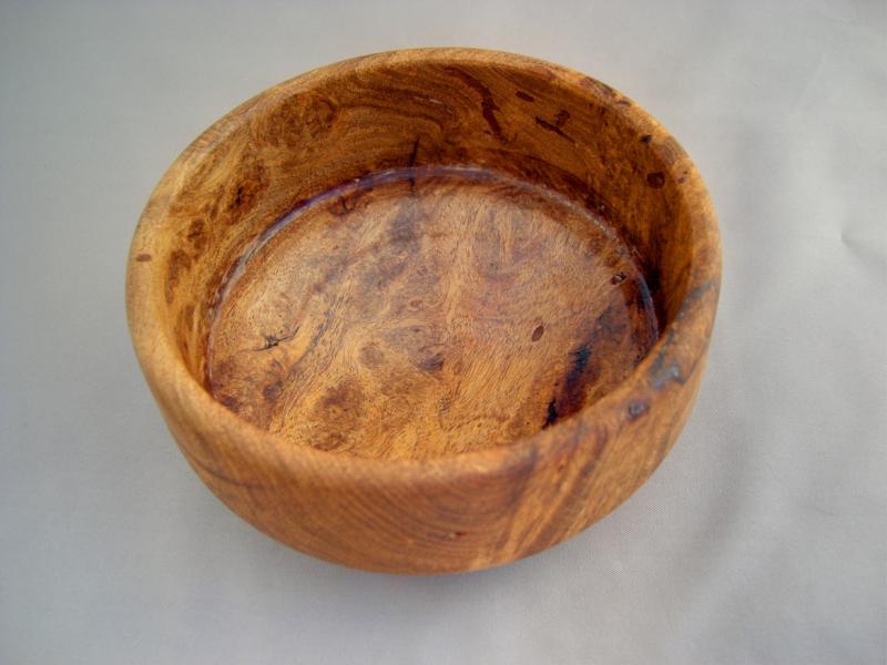

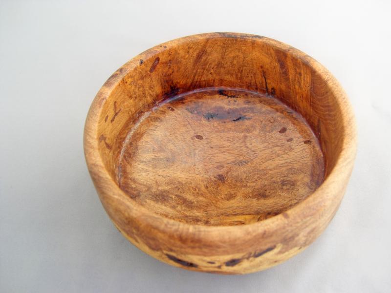

This is my first real attempt at a bowl, I found out it is tough to turn a bowl with pen tools. Any ways this is some mesquite burl that I found in a ditch last weekend and drug it home. I left some of the rough stuff on it other wise it was not big enough for a bowl blank. I stabilized the bark area with thin CA before turning I also found a ton of worm holes. I sanded it smooth then applied a BLO/CA finish, it will be a coin catcher.
Any Comments or tips welcome, Thanks for looking. :biggrin:

Max, mesquite in NV? but anyways beautiful work,nice find and save. BTW, how did you manage to have a large horizontal post with Horizontal pic next to each other like that? Unless you have a 36" screen hooked to your comp?

Real nice first bowl and beautiful wood.
I have never turned anything in mesquite . Never seen a piece in my hand but love seeing it in finished projects like that.
A friend from way down southern USA is going to be sending me some mesquite once he gets it cut and packaged just for the price of postage.
I am really looking forward to that and hope it is half as nice as the piece you turned.
I have heard that it is one of the few woods that can be turned right from green to finish without any warping or cracking.

Humm, not bad, not bad at all, even tough I're reckon finishing a bowl with BLO/CA would be a B!@$...!:eek:
If I hadn't seen the top of the bowl, I could swear that the wood was Australian SA Black Wattle, my #16 on the list, all the pics shown from the bowls under wood are exactly what my #16 look like, apart from maybe that resin pocket!
Practice, practice my friend, it will help a bit..., well..., a lot...!:wink::biggrin:

Well done, Maxman! You really should be proud of that one. It's one of the toughest shapes to turn with the straight sides and flat bottom. As already mentioned, you chose one of the more difficult finishes for a bowl.
Sign it, maybe number it as some do, and hang on to it.

Very well done for a first bowl. It should only get easier; those straight sided bowls are harder to turn than more traditional shapes.

Of course, the bowl you're looking at is burl; regular mesquite looks a little different, but is still a beautiful wood.
Although mesquite is highly touted as "the most stable wood around," it will definitely crack, especially around the pith - but the cracks will be smaller and more manageable than most other woods.
