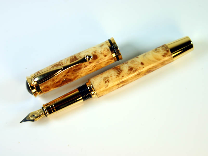

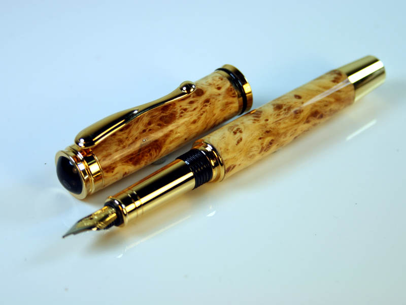

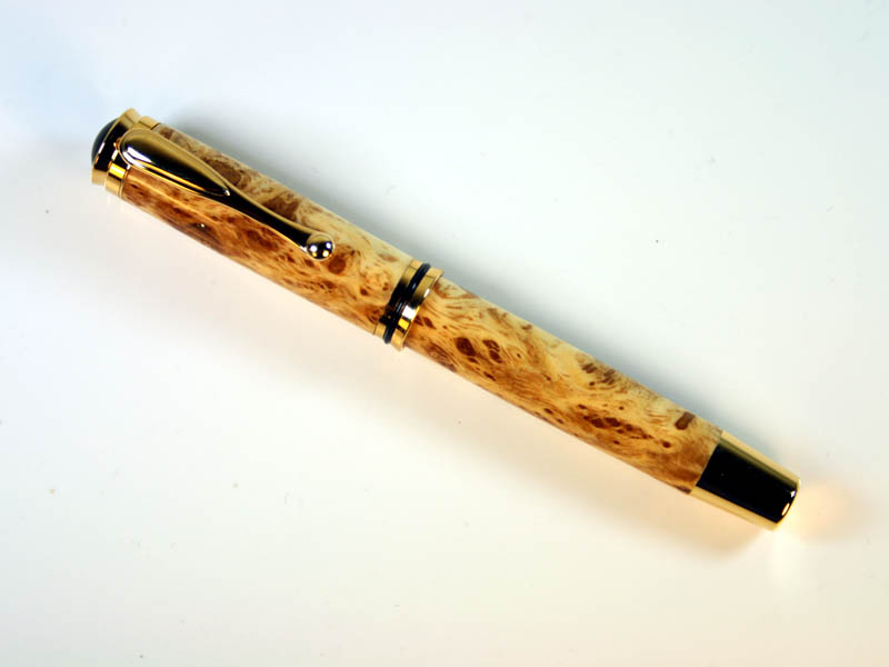

It has been a while since I have had a chance to turn some pens.
This is a JR Victor (aka JR Retro) Non-post-able version in burl eucalypt sapwood.
This is my first attempt at a JR Victor. First of many hopefully.
Sanded to 400 grit. CA Finish - 20 thin coats. Sanded to 2,000 grit. Brasso, cornflour then automotive wax.
I am really happy with this pen! hope you like it too.
Thanks in advance for any comment or suggestions for improvements.
Regards
Timberbits.
