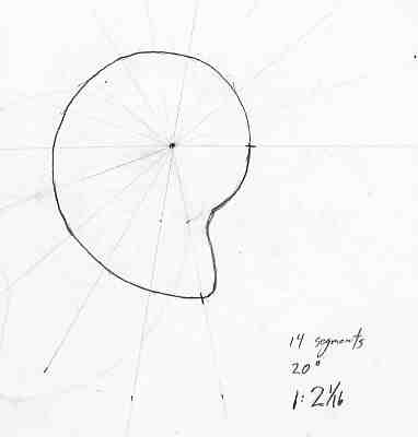

Make a wooden frame out of 4x4 hardwood. Have 1" through-holes in the top rail and 1" counter-sunk holes in the bottom rail 3" in from the inside edge of each rail. Also have 1" holes 2" down from the inside edge of each side rail.
Between sides of the frame add a 4x4 movable piece that has a 1" hole in each end. To the bottom of this piece bolt two pieces of angle iron to sandwich your cutting blade. Either through-bold the blade or tap and thread one side of the angle iron to add clamp bolts.
Use 1" black iron through the holes in the top rails, through the movable piece, and into the counter sunk holes in the bottom frame rail. Mount "weak" springs over the 1" black pipe on each side under the movable piece.
Build a Cam-Shaft by using a piece of 1-1/4" black pipe and attach several matching cams made out of 1" hardwood along its length. Add a handle perpendicular to the camshaft (maybe using a X or T coupler?). Place the cam shaft between the holes in the side of the frame rails. Slide a 1" black pipe through the entire thing and put end-caps on each side so it doesn't pull through. Pulling the lever down rotates the cams which push the movable board down and cuts whatever is under it.
Size the width of the frame to match the width of stuff you are cutting. Size the height to fit all the above plus the height of the material you are cutting.
You should be able to build the entire thing for ~$30 if you buy everything new.
Here is a picture of a simple cam that you can blow up on a copier to the size you need.
Just my thoughts off the top of my head. Hope it helps!
