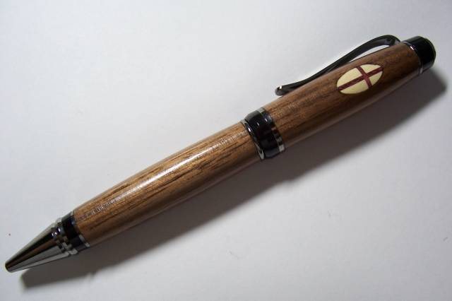

Here are some pics of the finished pen:
A pic of the full pen, looks great doesn't it? :D

oh and before Skye says it "i can see sanding lines"[:D]
probably due to the bright light used to photograph it.
bet you wouldnt see those lines without the camera light on it.

Correct me if I am wrong, but I'm not so sure those are sanding lines. If you look at almost any wood pen (Walnut and Maple tend do show more than some others) you will see a line from the top to the bottom of the pen that is a pattern change in the wood which results from turning the wood round. This pattern is also visible on the opposite side of the pen. I use these lines to make sure I have "lined" up the pen correctly upon assembly.
It looks like on Josh's pen the line happened to be highlighted by the lighting.

JasonF,
thanks for explaining that. I did not know that and i have turned black walnut before. Good eye.
dang you can teach an old dog something new[B)]

leatherjunkie, those are not sanding lines, it's the grain of the wood. I went over that blank with everything short using a magnifying glass. [;)]
JasonF, Yes you're correct, those are grain lines. The ones that I've done so far that produce that effect are Walnut, Brazilian Cherry, and Cherry.
