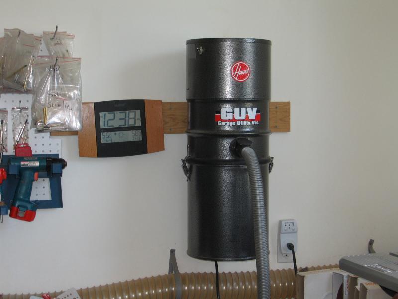

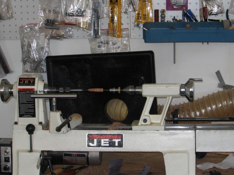

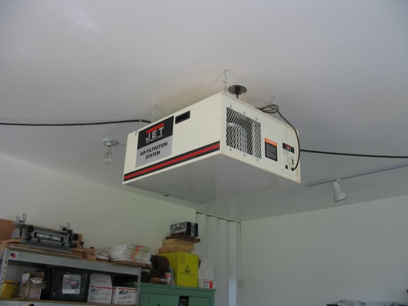

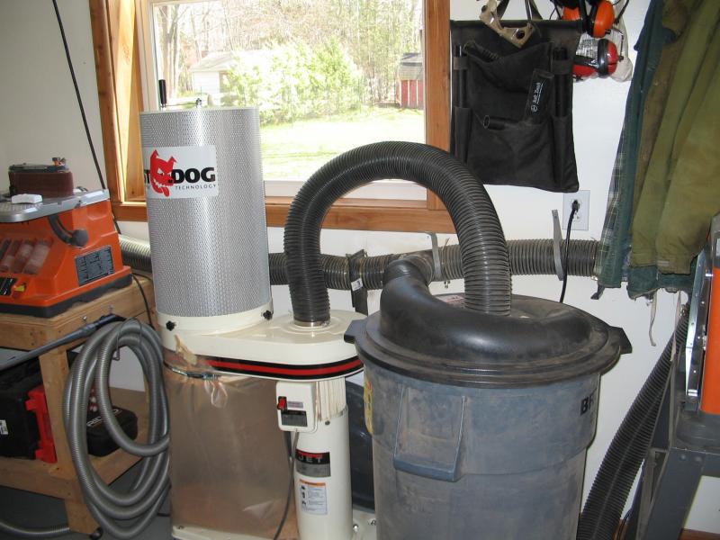

No debate intended here, but reading other threads got me wondering if I do enough in this area. I don't wear a respirator unless I am dealing with vapors.
I recently "cleaned" my shop after a couple of years of turning just before getting the 1 micron (I think) filter for my Jet dust collector. I also have the Jet air cleaner and a Sears GUV (garage utility vac) for chips and larger debris. My shop has remained amazingly dust free since adding the new canister to the dust collector.
I turn Cocobolo and my nasal secretions remain clear---I realize this is not a real scientific study.
Should I be doing more?
All comments appreciated.

I think that the Jet or any other air cleaner is the ultimate solution when you have all the other dust collection units. I made my own air cleaner from an old furnace fan and use one layer of paper towels over 2, 20" x 20" 0.5 micron filters. the paper towels get grey/dusty after one or two turning so I change them often. The dust collector connects to my machines and turns on and off as they are used but the air cleaner fan is on all the time I am using woodworking tools in the garage - lathe, table saw, sander, jointer, etc. The end result of this is that I get minimal dust on the vehicles in the garage.

One of the best additions to your system and is a great time saver in the long-run is the cyclone trash barrel lid for pre-separation of larger parts from the turning process. I might suggest that you put your plastic bag on the JET into a properly sized trash can to avoid any possibility of rips to the bag and the ensuing mess ... DAMHIKT!!
