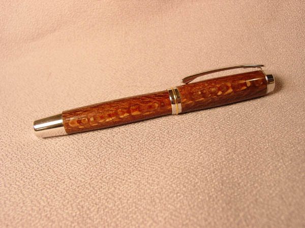

Browsing through the photos section, i came across a great example of Depth of Field. this is Scott's Photo. Sorry Scott i should have asked before using it. Hope you don't mind.
Image Insert:
67.55 KB
For those of you that are clueless about just what depth of field means.
It is the area between the nearest and farthest points that are in focus.
Now although Scotts picture shows a wonderful pen. I need you to ignore that for just a second. Look closely at the cloth it is laying on. just in front of the pen at the bottom edge of the photo.It has been crumpled up a bit so the line where it comes into focus is a little hazy but you can make out in the texture of the fabric where it is. then look behind the pen and you can make out anouther line where the focus is lost again. the space in between is the Field of View
Notice that Scotts pen happens to land squrely in that field. all of it. It is easy to have something like the clip be outside of it. or if you are taking a picture of a pen end on. the tip may be in focus while the other end is not.

Hi Daniel,
No problem using the picture! The only thing is that the link only led to my album, not the picture. Tell me which pen, and I'll fix up a good link to it.
Nice explanation of depth of field! It's not an easy thing to describe. Now we need to go through the steps of figuring out how to affect the depth of field on our digital cameras!

Scott,
It is on the first page of your album. lower left corner. Unless you know of a better example. I saw a picture of a spider web once that was probably the best example I have ever seen. the effect the Depth of field had on the photo was fantastic. anyway I can't find it again and yours caught my eye.
