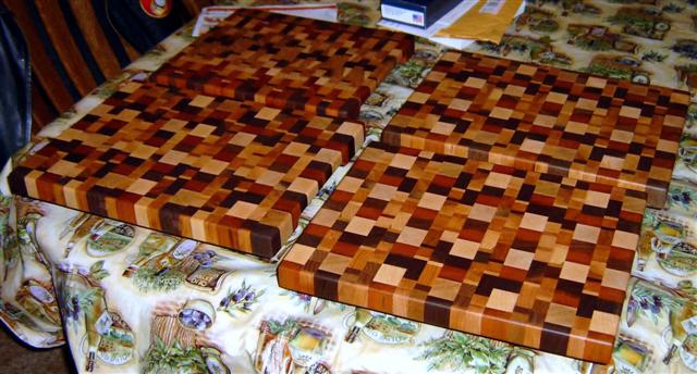

I made these for our three girls for Christmas. The smaller was the prototype and LOML claimed it. All end grain and the majority is Maple, Cherry and Walnut, with a few odds and ends of QS White Oak, Beech, and Butternut thrown in for contrast.

Very nice! What did you finish them with so that they are safe for food preparation?

Sorry, Ron, I thought I included it. I use mineral oil on almost all of my food utensils. It's inert and doesn't turn rancid like most other oils. Ocassionally I will use a mixture of bee's wax and mineral oil, but it depends on the piece.

billy, how did you clamp the pieces up initially? a bunch of mixed boards together and then ripped them into 1 inch pieces or whatever and then a second glue up? again, great looking pieces!
recently i made a cutting board in my cold, cold shop and it bowed something fierce after gluing... i planed and jointed all the pieces before glue up, but i'm wondering if i should have glued only 2 or 3 at a time before gluing the whole thing together... any suggestions? they were pieces of walnut and maple alternating, about 4 inches wide each. i tried to alternate the endgrain to prevent mass warp... perhaps it was the cold shop followed by bringing it inside after the glue set up? your thoughts are appreciated...

Thanks, all! Yes, Andrew, I glued up the long pieces and planed them smooth. Then cut them to length and glued them again. Suggestions? 1) Get a heater for the shop. Drastic temperature humidity changes make wood move... sometimes alot. 2) Make sure the wood has acclimatized to the shop for a few weeks. 3) Only glue up as many as you can work with before the glue starts to set up. 4) If the initial glue-up bows, but was flat when glued, you should be able to straighten them out when you do the second gluing.

Thanks for the kind remarks, fokls. Just a word of caution for those who want try these. Don't be stingy with the glue and be careful not to starve your glue joints. DAMHIKT[:0]
